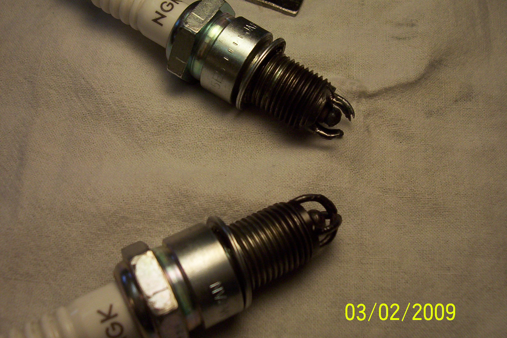

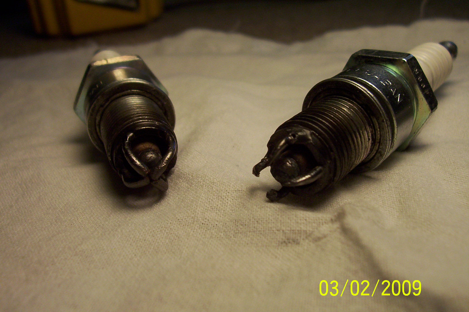

      I need to show you what problems I am having after running plasma ignition for 30 miles only. I am running the same oscilator as greg but instead of the four NTE517's I used 50 IN5408 in each leg going to sparkplug. I used these because I had them.
      Both plugs were run at the same time and distance. I think the one plug was eat up so much more because the tangs did not touch in the center like the others. I have run these plugs many many miles with no wear that I could see on standard ignition. But it is obvious they WILL NOT WORK with my type of plasma. I think Greg's plugs are made of different material. Mine are made from steel tig welding rod. What do you say Greg? How are your plugs holding up? and are you using nickle plugs? Mine are not nickle but steel ball and grounds.
      Bob

          Hi Bob,
          How big is your CDI Cap? How many Joules of energy are you pumping through those puppies?
          I had measurable wear in my initial test ... about .007" on a standard configuration non-resistor plug ... I posted the pics way back and that report was for a 300 mile run. Have not resumed testing yet ... soon. I do have two of the nickel plugs installed and have about 200 miles of just running around. I'll pull one out and post some pics soon.
          Greg

              Greg my cdi cap is 3 uf oil filled , I didn't have a 2 uf like you and my voltage is running about 220 volts. The resistor is 500 ohm like yours. I failled to say what kind of tig rod for the ball and grounds, I went back and corrected that, but they were steel. I am at a dead end as to what to use now, maybe chromium? Bob
