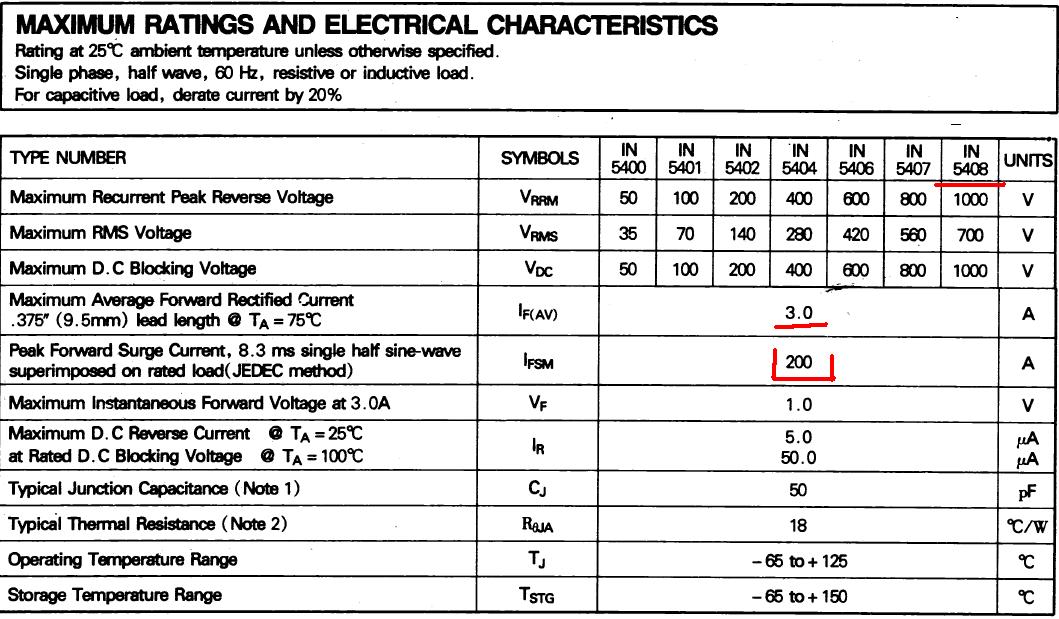

    I = W/t *1/U, when asuming t == 11us, getting I = 330A (its a peak I)
    this is asuming only 10 times normal spark, but Lee's PLASMA scope shot already showed, it's maybe faster. And you also say its only few nanoSeconds, not thousand, or even some us.

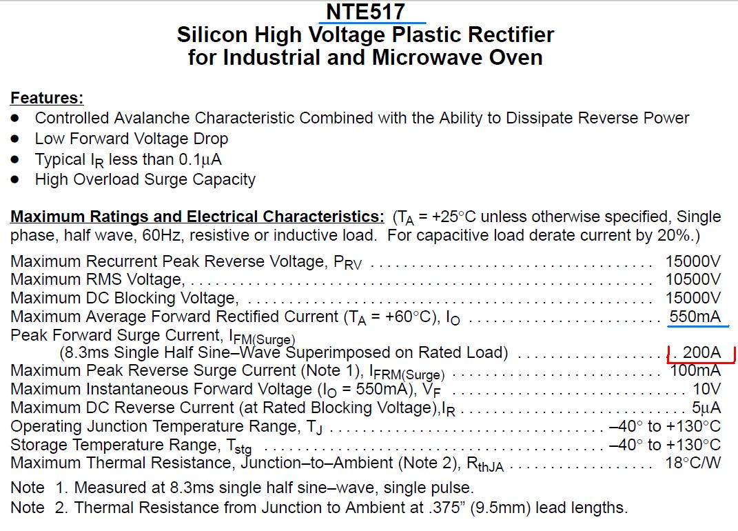

    So, this peak i is higher, probably much higher than Peak Forward Surge Current of diodes. No matter if 1N5408 (200A) or NTE 517 (200A). (Average Forward current is not the matter, max. 180mA @ 6000rpm.)
    As I have written above, I "like" destroying diodes, and dont know why. Having a "chain" of 25 x 1N5408 on cylinder 1 and cylinder 2. Both were never an issue.
    But the 2 other one's....
    Will look for NTE517, and mount it on, no far away from cylinder 3 and 4.

      Second, I don't think your diodes died cause of the high current. It is more likely it is too high voltage to blame. I used a string of 1N4007 (max 30A) and they had no problem with the heat (as you know, Q=IxIxt, and that means that the generated heat depends firstly upon the current). The high voltage killed them. There were only 25 diodes in my string (that could block only 25kV), and my ignition coil was capable to output as much as 35kV... When I accelerated too fast (recquiring more kV from the ignition coil), they died.
      There is another issue here. The diode string has a certain resistance in itself. Their reistance is not zero. There are maybe a few tens of Ohms, and that lowers the current running through them when capacitor discharges.
      For example, if your capacitor is charged at 400V and the diode string resistance is only 10 Ohms, the current couldn't reach more than 40Amps.

        • Nte517
          Hi everyone,
          I'm not getting the point of this thread, but I will say that in my present circuit I am discharging 350 VDC in a time similar to the trace I posted earlier. I use 4 NTE 517's in parallel. Almost no heat. Also look at the VexUs circuit and note the direction of the diode. It is like the Tero arrangement but only one diode and an air gap ... counter to others.
          I have never lost any NTE517's either in lab development or vehicle testing. The diodes are not seeing the current that is at the spark gap. The diode sees voltage and not current in these circuits. The spark gap self-modulates the power thereby "producing" the current "within" the spark gap. The conversion of power (volts to amps) happens "BY" the spark ... not the other way around.
          It's very hard to explain.
          Greg

                    • In the plasma spark circuits, the idea of connecting 1N5408 diodes in a string is to divide equally the total reverse voltage among them. So, if the voltage is 25,000 and the strings are 25 diodes, each diode theoretically will be exposed to 1,000 volts.
                      However, if each diode has different reverse voltage leakage currents, then the 25,000 volts will not be shared equally. The diode with the lowest leakage current will be exposed to the highest voltage being shared.
                      ON semiconductor rates their diode at reverse voltage of 1000 volts at 25 deg C with leakage of 10 uA max. and at 150 deg C with leakage of 100 uA max. No values given for typical or minimum. So, in a mix of diodes, each one can have different leakage currents from each other.
                      Example only: 10,000 volts and 10 1N5408 string, first diode has leakage of 1 uA, next 2 uA, etc. For analysis only, at reverse voltage condition, let us replace each diode with a calculated resistance value.
                      diode D1: R1 = 1000/.000001 = 1000 megohms
                      diode D2: R2 = 1000/.000002 = 500 megohms
                      diode D3: R3 = 1000/.000003 = 333 megohms
                      diode D4: R4 = 1000/.000004 = 250 megohms
                      diode D5: R5 = 1000/.000005 = 200 megohms
                      diode D6: R6 = 1000/.000006 = 167 megohms
                      diode D7: R7 = 1000/.000007 = 143 megohms
                      diode D8: R8 = 1000/.000008 = 125 megohms
                      diode D9: R9 = 1000/.000009 = 111 megohms
                      diode D10: R10 = 1000/.0000010 = 100 megohms
                      Sum of R2 thru R10 = 1929 megohms. Add R1 = 2929 megohms. Reverse current for string is 10000/2929000000 =3.4 uA. Voltage across R1 or D1 = I x R = .0000034 x 1000000000 = 3400 volts. This is over 3 times its rated reverse voltage and will fail usually in shorted condition. Then the next diode could fail like a domino effect. End of example.
                      Now if each diode has the same value resistor across it lower than 100 megohms but still high enough not to affect performance like 22 megohms or 10 megohms. then the effect of differences in leakage currents will be minimized making the 1N5408s survive. Just my analysis, I don't know when I can test.

                            And thanks 'insane4evr' for your complete, enlightening and sobering analysis spelling out the possible results of just stacking up a bunch of parts with slightly varying specs.
                            I know ... pricey... $6.29 ea. for me ... $100 in diodes - OUCH! I use 4 ea. in parallel to be super conservative. I have run continuously at 2 ea. in parallel and they still don't go past their rated temperature. I just don't like electronic things getting so hot they burn me when I touch them. You don't want to get too hot though because resistance increases with temperature forcing more current through the cooler one, then it heats up and you'd think this would be self-modulating/self-moderating but you might hit a thermal resonance and one will just get too hot and 'pop' with the remaining one failing in over current ... remote scenario, but possible.
                            I think 3 parallel is safe ... I was just in a soldering mood.
                            Greg
