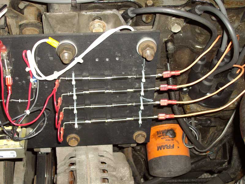

I finished mounting the hardware and here is a pic of the mounting panel I use to hold my stuff.
On the left is the 24 Watt support oscillator. Far right is the voltage multiplier that supplies 400 VDC to 350 VDC from 0-RPM to 3,500-RPM. The numbers are slightly different than from the bench ... to be expected though. Between them is the power supply cap (may not need it). Above the oscillator is the 500 Ohm anodized aluminum power resistor (current limiter / charge resistor). To the right of that there's a terminal strip and at the top is a 3 uF HV cap. No more storage cap because the multiplier serves that purpose.
I plopped it in, plugged it in and went for a 45 mile trip on the back roads. Wound the engine out, lugged it and ran it normal ... the whole nine yards. I hooked up the scope and got the typical discharge curve I've already posted. Getting ready for a water vapor test now .......... FINALLY !!!

Hi everyone,
