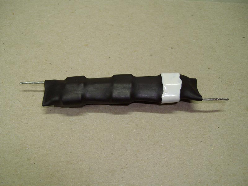

            • Bill's Nexus Circuit Test Two Update
              I finally received my isolation transformer today and performed some testing. I first tested the circuit with an isolated battery to ensure that the inverter primaries were isolated from it's secondaries. It worked just as I expected. The hot side of the inverters output is totally isolated from the vehicle battery, the neutral side still reads 120 VAC but I guess it should seeing that it is tied to the vehicle ground. So when I tested the circuit on the vehicle battery, the inverter held up just fine. I was a little worried due to all of the TVS use that has been going on, but I figured what the hell I'll give it a try. It did not seem to affect the inverter, but I was only running one plug. Just for safety sake, I think I will order TVS's just to make sure.
              I also replaced the MOT with an electric motor coil that I got out of the fan in the microwave. The spark was not as great, but that should be due to the fact that the MOT has 0.7 ohms of resistance and the little coil has 103.7 ohms of resistance. The little coil worked just fine and of course is 10 time smaller.
              I only used 15 diodes in this test because of just testing one plug, and that also worked fine. I found a neat way of packaging the diodes. I soldered them all together covered them in liquid electric tape, then folded them and wrapped them in heat shrink. Works great and a lot smaller package I have posted a couple of pictures before and after the shrink wrap.
              I made a video of the test and I'm in the process of uploading it as I am writing this. I will post a link once it is completed.
              Next step is to install this on all four plugs and see how she runs.
