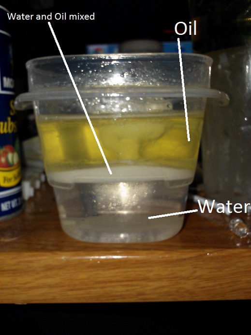

        • So the problem I run into is that from my studies water corrodes the electrodes in a cell. Oil on the other hand does not harm the electrodes of the cells but oil doesn't give you any voltage either. Its pretty much black or white, either you want power with corrosion or you want no power with no corrosion and it seems there is no gray area? What if we could get the best of both worlds? The power of water but the protective nature of oil? We all know water and oil don't mix, or do they? A liquid that was conductive like water but protected the metals like oil does. In the picture below you see oil on top, water at the bottom and new liquid that has combined oil and water into one liquid. Its a liquid that is conductive like water but protective like oil. It gives you your voltage and the amps you seek that water normally gives you but also gives you that layer of protection that oil gives you. I've been searching awhile for this type of liquid, I'm still trying to perfect the technique.
Name:	Water - Oil - Mixed.jpg
          • I've been working on the idea of mixing oil and water into one liquid for some time now. I do more than make mircoamp cells. I wanted a liquid that acted like water but was protective like oil. One of the my early attempts at making oil and water combine into one was when I also added in Alum, the kind John Bedini uses in his copper bowl cells, and got a amp reading of 5.58mA from two small electrodes. The picture below shows this. This was one of the cells that showed good promise of high power output but was far from perfect. This combined liquid affects each electrodes differently. Some electrodes paired correctly won't even create hydrogen bubbles which is odd because the same electrodes in water will create the bubbles. The lack of creating hydrogen bubbles makes the theory of these cells being a fuel cell hard to grasp, but I can only speak for the cells that use this liquid.
            I hope this research is helpful to others, let me know what you think.
Name:	Water and oil mixed - alum mixed in version.jpg

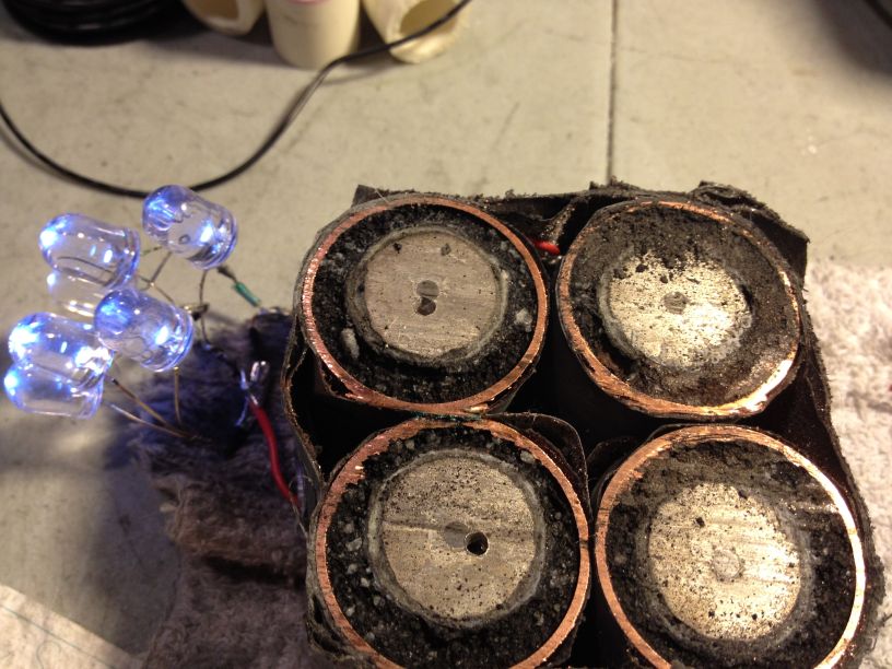

            • I opened one of my cells that have been running for about 6 months or more non stop and to my surprise the level of corrosion is minimal but the best is that around the Magnesium some black skin is formed that seems to be protecting it.
              Fausto.
              • Originally posted by plengo View Post
                Fausto.
                Great to hear from you Plengo!
                Black corrosion is good and white corrosion is bad. White corrosion is destructive and black corrosion is protective. Certain combinations of liquids will create this black layer and others will create white layers.
                Do you have anymore cells like this?
                • Black protective layer on Magnesium
                  Fausto.
                  That's the same effect I have noticed after removing the magnesium rod from the ground. If it doesn't rain for a while, the joule thief doesn't care and the light stays bright at night. After a couple of months of decent constant lightning, a thick solid brown/black layer builds up on the Mag and it doesn't seems to deteriorate at all. Every times it rains outside, the white led gets it's intensity right up. The copper stays black and there is no signs of degradation. I really think we should focus on what this protective layer is made of ??.
                  It's like on the water fuel cell. On the stainless steel plate, after the conditioning process, a withish powdery layer is forming on the negative plate and the water fuel cell dramatically incrases it's hho production. For more effeciency, we need a freqency generator for the resonnance of the cell.
                  In the case of a crystal battery, it's the opposite. I think we need to condition the magnesium but the joule thief is acting like a resonnance device for more power output of the cell ?? I do think that the cell is actually our input (vs: wfc is the output) and the JT is part of the output. We need to investigate on this but I'm sure John Bedini is already aware of what's really going on.
                    Fausto.

                          No this is not using the grease, only activated carbon, sand and alum.
                          Btw, the picture is from a cell that I cut it in half using a bend saw and one can clearly see the level of corrosion internally. The rest of the cell is pretty much the same.
                          Now i ALSO have some cells that the magnesium became 100% white-ish and very soft. Usually when that happens I give the cell up and it is trash BUT I found out that if you build the cell with a enough internal structure to not let the white oxidized magnesium fall apart it still works.
                          Off course the wire attached to the Mg get loose but I inserted a cooper rod straight inside that white Mg and it still works like a charm.
                          I am totally confused with this finding (while it does explain why certain cells of mine are running over 1 year). One would think that if the Mg gets that corroded (white) it would no longer produce energy but in my case it is working just fine.
                          I noticed that excessive water and alum will corrode anything BUT if you build this and let it dry and when it becomes a rock solid inside than adding water makes no difference any longer and the cell works very well.
                          I am concluding that those cells are two things at once. One is the regular corrosion (galvanic reaction) and the other is the fuel cell part of it.
                          Now I understand WHY Bedini makes his cell rock solid first by melting and letting is solidify with Mg inside while having the locked water molecules in the mix (via for example with Epson or something that have many molecules of H20).
                          I am pretty confident now that with proper building one can indeed create a fuel cell out of this thing (fuel cell in the sense that water is converted into electricity and its molecules parts like O2 and H2).
                          Another cell of mine has the oxidizer inhibitor (MnO2) and also works very well helping to avoid the Mg becoming white.
                          Too much water on the cell before it is rock solid will kill the cell.
                          Now I am playing with a new geometry internally where Mg can become white and not break apart therefore continue running and also provide a good region of growth for the Alum.
                          Alum to me is the one that creates infinitely small tubes where the water flows and breaks apart into its components. As the water breaks apart it gives off its "electrons" and also generate a magnetic field inside the cell that cuts the metal and, by Faraday's law, create a flow of current because of the changing magnetic field.
                          This is just my opinion but I am starting to understand how this water thing is so important for those cells.
                          Watch this video (A Physics Lecture, and demonstration at MIT -- Kelvin's Thunderstorm "Water Battery" - YouTube) and you quickly will realize that water when falling will be oriented by the Earths magnetic field and as they do they build up a very local magnetic field and grows as the water falls. This magnetic field will cut those metal pipes of the structure of the aparatus and create "electricity". So does the crystal cell.
                          Fausto.

                              Yes, heat increase power. My cells off course run on room temperature.
                              I am playing with one formula (94 in my notes) that is working extremely well. It is Activated Carbon, Sand and MnO2. The MnO2 will absorb the Hydrogen production and help reducing oxidation (I think). If H2 is not free to fly and build up it must be absorbed by the mix which is reused by the water molecules and therefore improve power.
                              This particular cell using that formula was almost dead (after running for over 6 months) and when I added very little water again, she is running full blast 5 10mm LEDs with no Oscillator giving easily 5 to 10ma (since the LEDs are full brigthness). This is very, very interesting.
                              The cell is rock solid inside, so letting it dry and only than add water again really worked plus the MnO2 that stops gas build up and also the cell of growing too much in size.
                              What I mean by growing in size is that the cells expand in size with time to the point one other cell of mine broke the copper pipe from within like reaping paper with your hands. An amazing pressure I must tell you to reap a copper pipe from within.
                              The Mg inside is intact with a cover of black and the mix is solid. Adding water produces 30ma or power, very impressive.
                              So I have many cells that together are building the story of how this thing behaves and what are the major factors.
                              Fausto.
