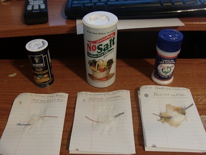

  • So i thought I would post my results so far on the different brands of salt substitute and what they do physically to the cell. I was only able to find two other brand of salt substitute near me besides Morton's. Here are the salt substitutes I found and whats in them.
    Morton' salt substitute = Potassium chloride fumaric acid, tricalcium phosphate and monocalcium phosphate.
    No salt = Potassium chloride, potassium bitratete, adipic acid, silicon dioxide, mineral oil, and fumaric acid.
    AlsoSalt = Potassium chloride, L -lysine mono-hydrochloride, cacium stearate.
    Most importantly all three contain potassium chloride and no Sodium at all. Also the Morton's and No salt contain fumaric acid and this seems to play a role in the picture below.
    As you will notice in the picture below we have one cell that doesn't look like the rest, that is due to it being heavily corroded away. The copper has corroded and the Magnesium has turned the glue brown and it too has corroded away. The other two cells are nice and white, I think since these two contain Fumaric acid and the third doesn't leads me to think the fumaric acid is helping to protect the cell from corrosion. If I find more types of salt substitute I will test those also, but so far I recommend Morton's salt substitute due to it has proven itself to me and to others. I do think No salt could be as great, if not better than Morton's, but as of now that can't be confirmed until more testing has been done. This simple test has proven that not all salt substitutes are the same.
          [ATTACH]10043[/ATTACH]
          Good test - looking forward to further results
