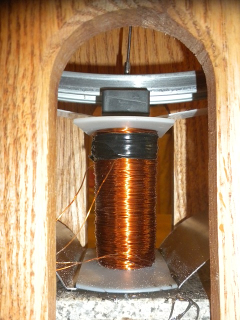

        • Coil wound
          I have my coil wound - 2 windings of 0.75mm (AWG#20) & 2 windings of 0.5mm (AWG#24). I still need to cut up the R60 rods for the core.
          @John B,
          Just want to check before I super glue the rods in. The end of the coil that was wound on last faces the rotor magnets, right? If this is correct and since I'm in the Southern hemisphere, the core needs to extend out of the same end, which faces the magnets.
          Since the height of the coil is 3.5" (90mm) I was going to cut the rods 5" (125mm) long. 1" (25mm) of the core will extend out of the coil facing the rotor magnets and I'll leave approx 3/8" (10mm) protruding out the other end of the coil so I can bond the steel sheet to the core.
          Pic of coil attached...
          John K.

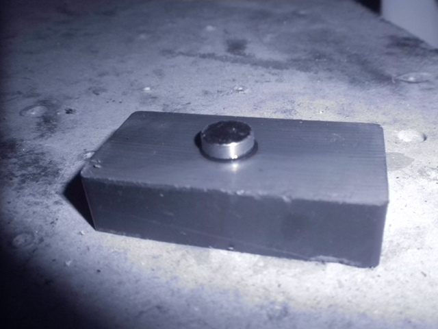

                      • Build Notes
                        Looking for some feedback and a couple quick questions...
                        Aaron's challenge doesn't define the coil. I've used my SSG coil, 850 turns of bifilar. As we proceed with this build, is this sufficient ? or should I start right away with a quadfiler ?
                        This is a 3" spool piece with 2" extended ..
                        See picture for small neo ...
                        This is the physical build... the electronics are ordered. I didn't have the NPN,PNP combo.
                        PS... John K... I'm following you ..
                        Thanks,
                        Timm

                          • Hi Timm,
                            Looking good so far.
                            If it were me, I would get the circuit running on the bifilar first to get familiar with it. Then once you have the circuit working, you can change the coil out.
                            I have a question for John about the neo magnet on the back of the ceramic, but I'll wait until I get to that stage later. I have a funny feeling it's not what most people think it is, but I'll leave it at that for now.
                            John K.
