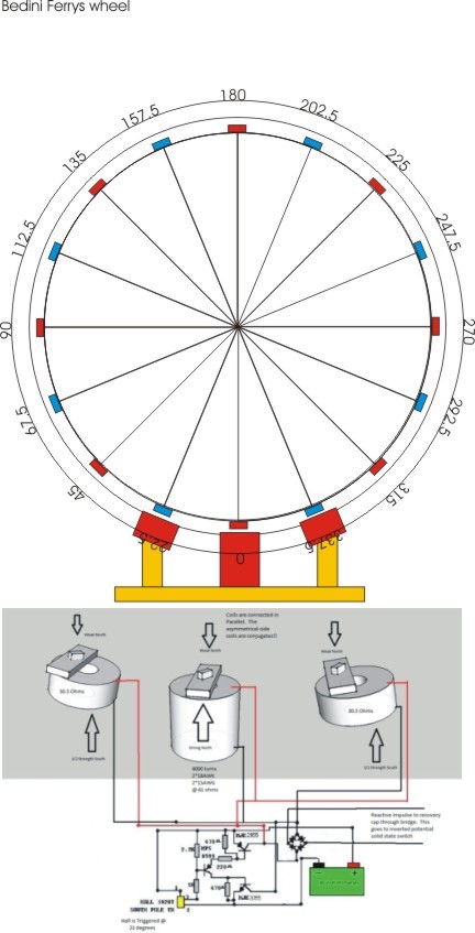

          Here is a modified circuit as I see it.

            • Nenergy,
              I believe you are close but have to adjust a few things.
              First all the magnets are North facing the coils..
              Second the three coils are not evenly spaced..
              Let me clairify. 360 / 16 is 22.5, but see post #69. The two smaller coils are
              slightly off 22.5. By my numbers, if you move the magnet over the center coil
              so the edge of the magnet is centered in the coil it has moved back 1.688 degree's. BTDC, according to a magnet 7/8 0r 19mm wide.
              NOTE:: IF YOUR MAGNETS ARE LARGER this may CHANGE THE DEGREE'S.
              This makes the first small coil at .844 degrees BTDC, and the second small coil
              at .422 BTDC.
              On another note. By my calculations the timing wheel is aprox. 12 inch's in dia.
              and has sixteen trigger magnets. Each would allow a window of 7.155 degree's
              for the hall switch to be triggered, and the timing for the dump to the cap. Still
              thinking about the circuit. Any one want to add to this info?
