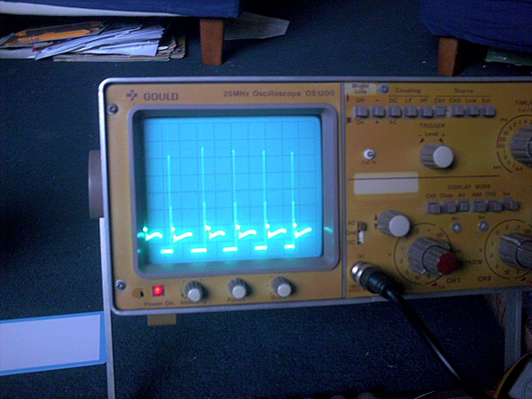

                • HURRAY!
                  I just got my oscilloscope and am at this moment looking at the h-wave in all its glory for the first time!
                  Still playing around with the controls but I have a feeling this is going to be a very useful tool!

                  • Originally posted by Sephiroth View Post
                    HURRAY!
                    [ATTACH]1013[/ATTACH]
                    Mart,
                    I had trouble getting the superpole to work originally. The problem was that the magnets that were strong enough to trigger the transistor single stacked werent strong enough to trigger the transistor in the superpole configuration because the north is alot weaker. I got mine working by double stacking the magnets on each side of the superpole.
                    CONGRATES Seph, now you can show me how to use my scope
                    Those are some very nice spikes you have there. Mine do not seem to go above 40V on my monopole, which has me puzzled.. Not sure where the problem lies.. The solid state bedini can easily hit much larger spikes but if the magnets is not needed to make the large spike, is the spike the result of high voltage?
                    Thanks for the insight on the triggering problem...
                    See my experiments here...
                    • Thanks Mart... Yeah, I'm really excited! Haven't tried hooking it up to a SS set up yet.
                      The photo doesn't do the spikes justice they shoot right off the top of the screen to around 180 volts!
                      But what is really interesting (maybe it isn't) is that this is a scope shot across the primary coil. This is the kind of shot I would expect to see if there is no charging battery connected. When you connect the battery on a standard SSG then the spikes won't visible as they are being absorbed by the charging battery. However this motor has a recovery coil and is dumping the charge and discharge into a capacitor no higher than 2 volts above the charging voltage.
                      Yet the spikes are still present in the primary coil! Does this show potential that is going to waste? Maybe it would be beneficial to combine the SSG with the Monopole Energiser
                      • RE: Scope shot.
                        Are you conecting from Case of the transistor to the negative of primary battery?
                        • from the collector to the primary positive.

                            • One to one Transformer effect
                              I think that seeing the spike on the pickup coil side, a spike around the 180V mark similar to what was observed on the energized side, has something to do with the 1:1 transformer effect that each coil has on one another. Even though I am saying this and writing this, I would think that in your case the Energized coil voltage spike is limited to say 12V as it is dumping its potential into the 12V battery would suppress the pickup coil voltage spike to the same 12V but in your case it doesn't do that?!!!
                              My SSG motor, with a multimeter on AC setting connected to pickup coil shows say 9.40 Vac and the energized coil shows 10.45 Vac. Keep in mind that the multimeter is not showing Peek to Peek voltage, but in my case (I don't have a scope) it seems that the 1:1 transformer effect is true. That is that the one coil potential affects the other. Peek to peek would be about 9.4 x 1.41 = 13.254 and 10.45 x 1.41 = 14.73 (this is approximate, because the waveform as you know is H not a sinusoid. if you assume a sine wave this is where I am getting the 1.41 factor... it is just ball park type calculation.
                              I wrote in a different thread that this 1:1 effect has a consequence of how the circuit works ( I can not explain now, because I would really have to review some literature, and also, I might find out I can not explain it fully, but the understanding and reality I believe holds ie 1:1 transformer effect).
                              I am thinking of getting an oscilloscope, I see that yours is 25 MHz. Is that good enough, or do you find that you need a faster scope?
                              Oh one last thing... made a Bedini lookalike circuit with a PNP transistor. I basically had to flip the pulse coil wires around so as to fire off the PNP. Anyway, the transistor I used seemed to work well, and I could run the motor without a charge battery with no problems, and also without a Neon bulb... anyway I was able to get 180V spikes (charge up a capacitor with a diode to 180V). I think that the 2N3055 NPN transistor is really hurting everyone's results when looking for the spike. I have read that the MJL21194 is better, and I will likely try it out.
                              Also, other stuff I tried just to see what would happen I hooked up an NPN Darlington transistor to my circuit and it reacted very much different than the 2N3055. The Darlington was turning on completely and off and drawing all kinds of current (say up to .6 ampre). I did not have enough resistance on my pot (2K was not enough) to give it much modulation. Maybe I needed something like 5K ohms to make the Darlington react like the 2N3055 Anyway..
                              Last edited by BinzerBob; 08-19-2008, 09:21 PM. Reason: Additional info about 180V
                              • Hi mart, the scope shot seems to be identical whether it is connected to the positive or the negative.
                                BinzerBob, I was a bit worreid that the 25mhz might be too slow but it seems adequate for viewing the waveform on a pulse motor, but might have trouble viewing the waveform on a solid state device but I don't think mine resonates above 25mhz so it should be fine. I'm just glad it works! You never know with Ebay
