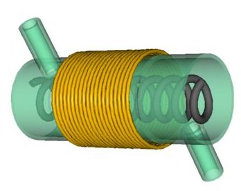

                • #83
                  2 coils? resist and induce?
                  What if the resistive heating element passed through an induction coil?
                  High Frequency Induction Heating
                  PJ
                  A Phenomenon is anything which can be apprehended by the senses.
