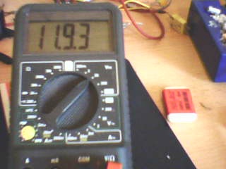

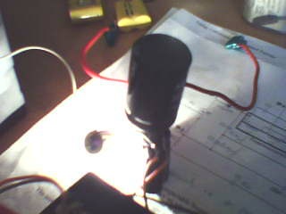

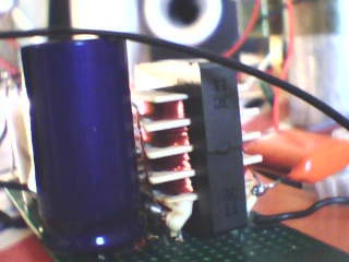

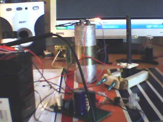

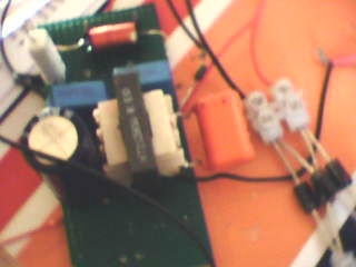

    No video, but photos
    Hi all sorry no video as my camera does not like the frequency I am using, instead some photos.
    Please note the neon on the cap which is in series with the return to the battery.
    In this test i changed to an air core transformer, gives a lower amp draw, 417ma.
    More to come
    Mike

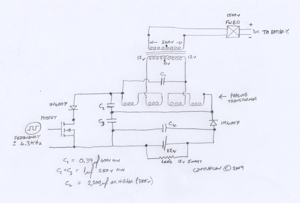

    The circuit at the moment
    Hi all
    This is the circuit at the moment and used for these tests.
    The phasing transformer should have a reasonable gauge of wire, the one I am using is a vertical type but a horizontal type should make no difference. The best ones are from the older TV's as they are of a heavier gauge.
    Use caps with voltages as shown or higher, there is very high voltage flowing around this circuit even before the output transformer (you have been warned)
    Mike
