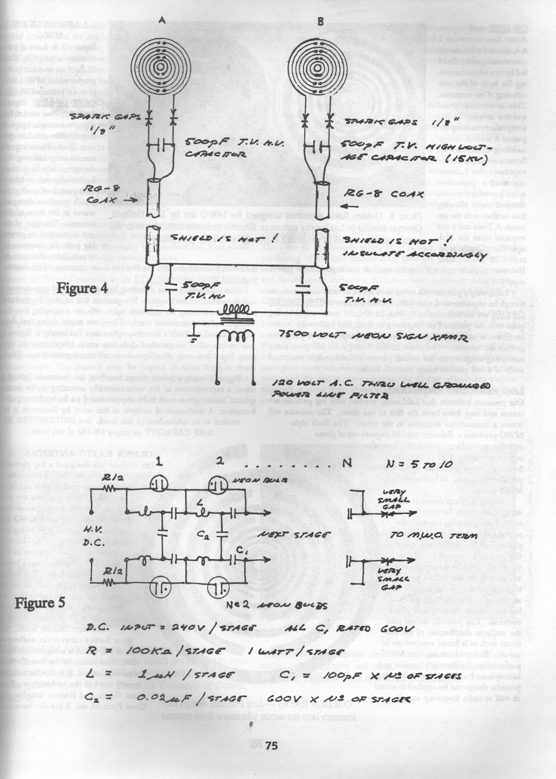

    Would it be possible for you to answer one question regarding one project which you're involved quite while ago (20 some years). I did replicate this setup together with log periodic antennas, exactly as you have design them. By the way, this is brilliant and they indeed "work" without power being connected. I'm talking about Multiwave Oscillator. I was hoping to ask during the webinar but there was no time for live questions.
    There was a variation of this circuit with two small (1/8") spark gaps at the antennas feed. What would be the benefit of such setup versus single spark gap. I have two setups running, both using bipolar TC but one is spark gap driven and the other is semi solid state (with spark gap as well).
    Thank you

    • This is the circuit I'm talking about -

                  Two spark gaps preserve the balance/2 phase form of oscillation. Everything must be absolutely symmetrical.
