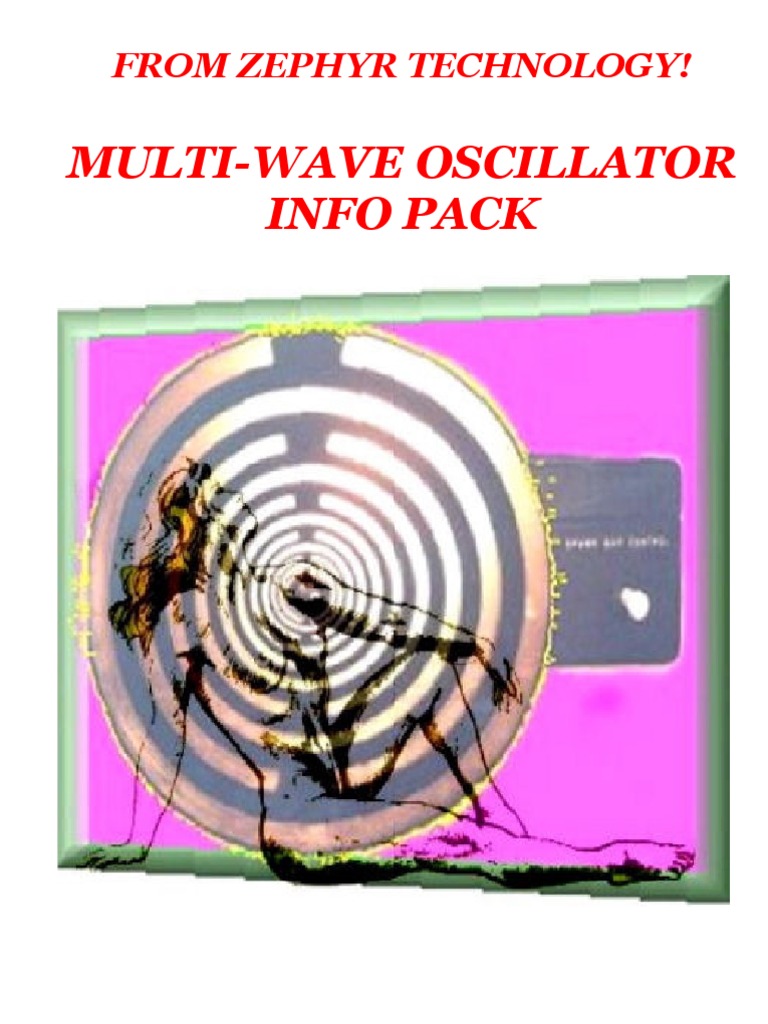

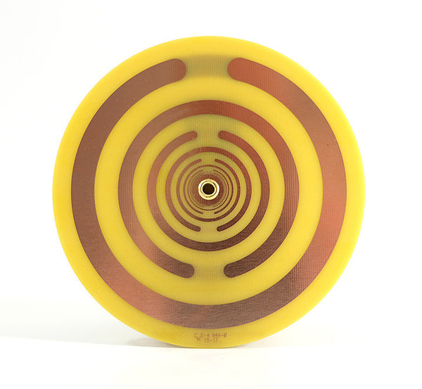

Eric Dollard
This is a sticky topic.
  • @ Eric, Raju/Invisible Sun
    Hello Aaron & Hello Eric!
    Based on pure logic and trajectory I refuse to believe the moon is the reason we had the total solar eclipse... I watch the moon, sun, sky, weather, etc., often throughout all times of the year. If the moon was the reason I would see it enter and pass the sun during the day, but we do not.
    Vedics as well as Indigenous groups in Colombia and others in Central and South America believe that Raju (2nd Sun that is invisible to our eye) is the reason for this.
    I've been charting my batteries being charged via solid state open loop circuits from potential difference and always note moon phases, sun, time of day, etc. The 2 weeks prior to the solar eclipse my batteries have been off the charts like I've never seen.
    Eric, does Raju play a larger role in powering our planet more than the visible sun?
    Anything you're comfortable with sharing would be immensely appreciated, THANKS!!!
    "Rebellion to tyrants is obedience to God." - Benjamin Franklin + Thomas Jefferson
    • Eric Dollard
      • Awesome!!!!
        We're all here for you Eric and our energies are with you!!!
        "Rebellion to tyrants is obedience to God." - Benjamin Franklin + Thomas Jefferson
        • sun
          Originally posted by ET-Power View Post
          If the moon was the reason I would see it enter and pass the sun during the day, but we do not.
          Ever seen a crescent moon in the daytime? Part of the moon is completely invisible to us. Sometimes, it is 100% invisible to us even though it is right there in the daytime sky because the sun is not illuminating it since the Earth is blocking the sun's light from hitting it. According to your logic, it should always be a full moon in the daytime. During an eclipse, the sun is hitting the far side of the moon meaning none of the moon facing us will be illuminated so obviously it will not be visible.
          Anyway, my opinion - not Eric's but I don't want this thread to get off track. Feel free to start a new thread on the Raja idea, etc...
          • @ Aaron
            Thank you for your reply and consideration to my question.
            During a normal Moon cycle, I do not believe the Earth is blocking a part of the Moon during the day when the Sun is in the sky and so is the Moon (crescent or otherwise). I have had troubles at times finding it when it's out during the day as a thin crescent but have still been able to find it. Just as I'm sure you have, I observe the sky day and night for years with charting of my batteries in relation to the Sun and Moon being top dead center and all other positions. What is being told to us doesn't make sense and I think Raju (another Sun) is a good possibility to explain this.
            My SINCERE APOLOGIES as I did not intend to ask an off-topic question as Eric studied the Sun for 6 years at Sonoma State so I thought this would apply. Sorry, for getting off track as that was not my intention.
            Thank you immensely Aaron for your time and all that you do for us all!!!
            Last edited by ET-Power; 08-28-2017, 05:53 PM. Reason: typo
            "Rebellion to tyrants is obedience to God." - Benjamin Franklin + Thomas Jefferson
            • Aaron: Love the photos. Whatever happened to the golden ratio antenna Eric developed for that?
              This is a compact sized Lakhovsky Multi Wave Oscillator Antenna designed precisely to Golden Ratio proportions. PLUGS INTO: Lakhovsky Multi Wave Oscillator instruments and devices. Can also be used with many other high voltage Tesla-type devices. Copper Tracings, Lakhovsky Multi-Wave Oscillator Device-connectable, 9 La
              freely downloaded from zephyrtech; including circuit schematic to build a multiple wave oscillator, lakhovsky, mwo, golden ratio antenna template, pcb template, em healing, cancer cure, detoxification
              • log periodic antenna
                Originally posted by Marcus Neuhof View Post
                Aaron: Love the photos. Whatever happened to the golden ratio antenna Eric developed for that?
                This is a compact sized Lakhovsky Multi Wave Oscillator Antenna designed precisely to Golden Ratio proportions. PLUGS INTO: Lakhovsky Multi Wave Oscillator instruments and devices. Can also be used with many other high voltage Tesla-type devices. Copper Tracings, Lakhovsky Multi-Wave Oscillator Device-connectable, 9 La
                https://de.scribd.com/doc/78094896/M...cuit-Schematic
                30 minutes ago we both sat down and drew out all the dimensions based on an original one a local friend has. I'm putting it back into production as time permits.
                • pre historic notion of charge
                  ricards, eliminate the physics notion of charge from your mind. steinmetz calls it a 'pre-historic notion' , see impulses waves and discharges book. 3 condensers in series, the dielectric induction distributes itself into the space between the plates or foils of the 3 condensers, that is why they are called condensers they condense dielectricity. if all 3 condensers are of equal capacity the dielectric induction divides itself into thirds, one third for each. however, inside the connecting conductors the induction contracts into its molecular dimensions. see jj thomson, electricity and matter.
                  73 de n6kph
                  Last edited by t-rex; 08-31-2017, 05:54 AM.
                  • Originally posted by t-rex View Post
                    ricards, eliminate the physics notion of charge from your mind. steinmetz calls it a 'pre-historic notion' , see impulses waves and discharges book. 3 condensers in series, the dielectric induction distributes itself into the space between the plates or foils of the 3 condensers, that is why they are called condensers they condense dielectricity. if all 3 condensers are of equal capacity the dielectric induction divides itself into thirds, one third for each. however, inside the connecting conductors the induction contracts into its molecular dimensions. see jj thompson, electricity and matter.
                    73 de n6kph
                    Hello Eric, what was the spacing (10 feet apart?) of your 24 ground rods in the San Andreas, San Bernardino fault lines with your 500 feet of silicon bronze wire you talked about several years ago? Did you bury the bronze wire or was it on the surface? Gauge of wire used?
                    What pattern did you use in laying out the ground rods?
                    In a circle or oval? or one straight line? Or several lines from a center collection point? or...
                    What would be the best layout and spacing to collect ground telluric electricity for say 24 to 60 qty of 8 foot long ground rods?
                    Barbosa and Leal, Brazilian researchers are powering homes and factories with their ground "electron captor" devices down there. THere is also Tread on this forum talking about this.
                    Thanks and keep up the good work!
                    Last edited by vrand; 08-29-2017, 08:40 PM.
                    • Hi Eric,
                      Can you comment on the receiver you use in this video:
                      Is this a "Crystal Radio Initiative" style Tesla Magnifying Transmitter coil built into the military radio and connected to the fire hydrant?
                      • Originally posted by t-rex View Post
                        ricards, eliminate the physics notion of charge from your mind. steinmetz calls it a 'pre-historic notion' , see impulses waves and discharges book. 3 condensers in series, the dielectric induction distributes itself into the space between the plates or foils of the 3 condensers, that is why they are called condensers they condense dielectricity. if all 3 condensers are of equal capacity the dielectric induction divides itself into thirds, one third for each. however, inside the connecting conductors the induction contracts into its molecular dimensions. see jj thompson, electricity and matter.
                        73 de n6kph
                        Hi Eric,
                        Thanks that makes much more sense, I will look at those books, got a copy of it.
                        I have another question hope you could answer too,
                        How do you see the Magnetism as the "Swirling of Aether", is it something like an underwater swirling vortex caused by an underwater current?
                        Thanks V. much
                        • @Vrand
                          The location of the grounding was at our "Camp David" facility at Bolinas, CA. Commonweal had it destroyed, just like Landers. The layout was a multiple star configuration, which radiated out from a common buss of 1 inch copper tubing. See the Bolinas "Barbara Boxer Report" for photos of Camp David.
                          I have a hard time believing that Brazil thing. Show me photos of the Kilowatt meter turning?
                          73 de n6kph
                          • @Neuhof
                            The receiver is a RT-66 out of a AN/GRC-9 setup. It is an excellent telluric radio since it has a "Tesla" front end. The coil is from the old Longitudinal Borderland video.
                            Transverse & Longitudinal Electric Waves and Tesla's Longitudinal Electricity - Eric P. Dollard - Official Homepage
                            73 de n6kph
                            • Originally posted by t-rex View Post
                              The receiver is a RT-66 out of a AN/GRC-9 setup. It is an excellent telluric radio since it has a "Tesla" front end. The coil is from the old Longitudinal Borderland video.
                              Transverse & Longitudinal Electric Waves and Tesla's Longitudinal Electricity - Eric P. Dollard - Official Homepage
                              73 de n6kph
                              Eric,
                              Thanks.
                              Are you saying that you modified the radio to add a "Tesla" front end?
                              Or, if I go on the surplus market and pick up a GRC-9 radio set, the radio will have the "tesla" front end built in?
                              In the video I linked ( https://youtu.be/C0e84XyuTjo?t=4m36s ) there is no large external coil like you show in the Longitudinal Borderland videos, unless I missed something.
                              I assume you are talking about this video:
                              There you show a large external coil out on the sand being used with the radio.
                              It's a very cool demonstration.
                              However the RT-66 radio in the original video ( https://youtu.be/C0e84XyuTjo?t=4m36s ) is not nearly big enough to hide that large coil inside the case.
                              The RT-66 also appears to be connected directly to the fire hydrant. There is no large external coil anywhere near it, as far as I can see.
                              How is it possible to receive directly out of the ground using the RT-66, without the large external coil?
                              • Answering questions from Facebook
                                [VIDEO]https://www.youtube.com/watch?v=DjbxTdcWBQI[/VIDEO]
