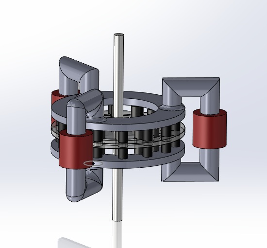

        @ Raui
        Thanks for the compliment! I think most skim by my concepts because they believe they are hearsay, or just an idea im kicking around. Most of the time, I have done many proof of concept experiments, toyed with many aspects of the idea, and done my due diligence. When I share it is usually a decently well developed concept. I just do not show all my work to how I got to that point. To me it is better to place the idea before people in its simplest embodiment, so that it can be grasped through good explanation, and imagination.
        @John
        I look forward to seeing what you have in mind. Below I attached a simple rendering of the concept, which could be greatly simplified so that a home shop could build. (the concept I show here has a one piece core which surrounds the pegs, this would be difficult to make)
        I will personal message you also.

                  • #24
                    Interesting design Armegdn03... just an observation that would make manufacturing a little easier.... if you made the top and bottom plates in a triangular form which would house the coils. This would elevate the large cores on top and bottom. The triangular form was simply an example based on your drawing, it could actually be made to house as many coils as needed. I do have a CNC plasma cutter...

                      • #26
                        Good I Idea, I think I see what you are saying. A CNC plasma cutter? ohhhh now there is a fun toy. Let me mull this over a little bit here, and maybe we can come up with a simple model to start with.
                        • #27
                          @Armagdn03
                          I like it
                          It looks like a solid design however we know mother nature usually has a way of foiling our best laid plans. When I built a similar design the first problem I encountered was that a magnetized iron core is for all intensive purposes a magnet in itself. As such when the moving core moves it induces a current (Eddy Currents) in nearby materials not unlike a Faraday disk. In your design this may be overcome by using laminate low reluctance materials such as silicon steel oriented radially around the point of rotation.
                          I don't like to use the terms Flux, lines of Flux nor lines of force but prefer a gradient of force or field gradient relating solely to field density. Which raises certain questions in regards to geometry, for instance I had built a similar design using an external moving magnet as a field source and the force on this magnet changed in relation to the motion of the cores as the field density in that space had changed and this change reflected back to the source -- stupid gradients, lol. One option may be to locate your magnetic source at the center of rotation which represents a position of least change then size the cores so that the field density remains equal. That is the core closest to the source is smaller than the core farthest from the source, different volume same field density. This relates to an obscure phenomena whereby parallel fields may represent a force acting outwards however the difference in field density between them acts inward, equal yet opposite.
                          In any case I like your design as well as the premise behind it and hopefully with a little tweaking everything will work as planned.
