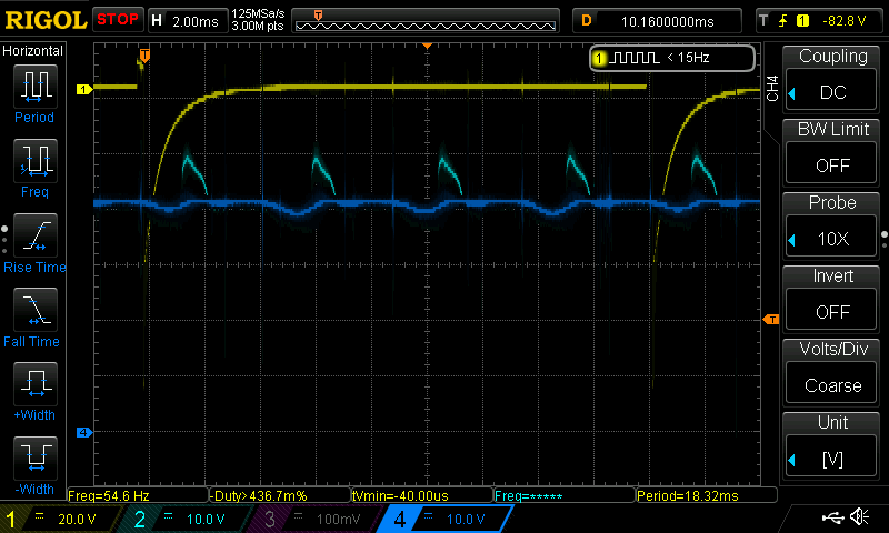

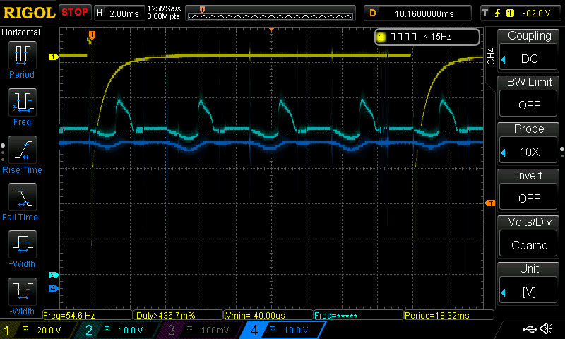

          • I placed a diode between the boost converter and motor to isolate what happens on the motor side.
            These pictures show voltage on both sides of the diode light blue is the motor side. Dark blue is the boost converter side.
            The yellow is just a marker to show where where everything is happening throughout a full revolution.

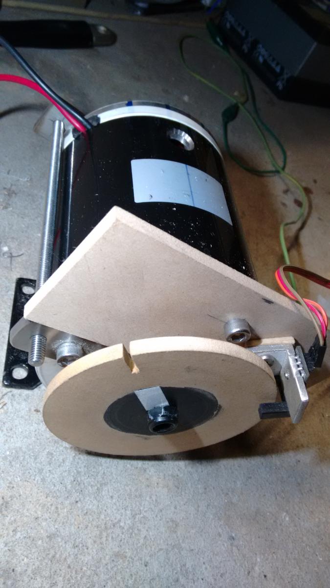

            And a pic of my 1020 motor
