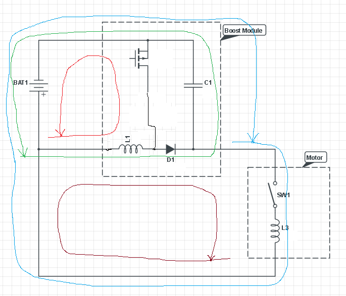

    • The same drawing marked up...
      I see 2 separate circuits making up 2 individual current loops sharing a common path.
          This is how I see it..
          The red line is the current when the Inductor of boost module is charged
          The Greed Line is the combined current that charges the cap when it is less 12v and the inductive discharge of the Inductor when the switch is cutoff..
          The Blue Line is the current of the to the motor-battery series on the parallel with charged cap of the boost module when on switch on position..
          The Brown is the Inductive discharge path of the motor on switch off position.
          ya'll see the average. on the wires.

            • Ricards excellent rendition of the currents flowing in the circuit clearly show that they all converge on the positive line adding to the total average of current.
              I was simply focusing on the positive line currents pointing out that this might not be a good measuring point to assess capacity and run time. It wasn't my intention for it to become a big deal... just an observation.
