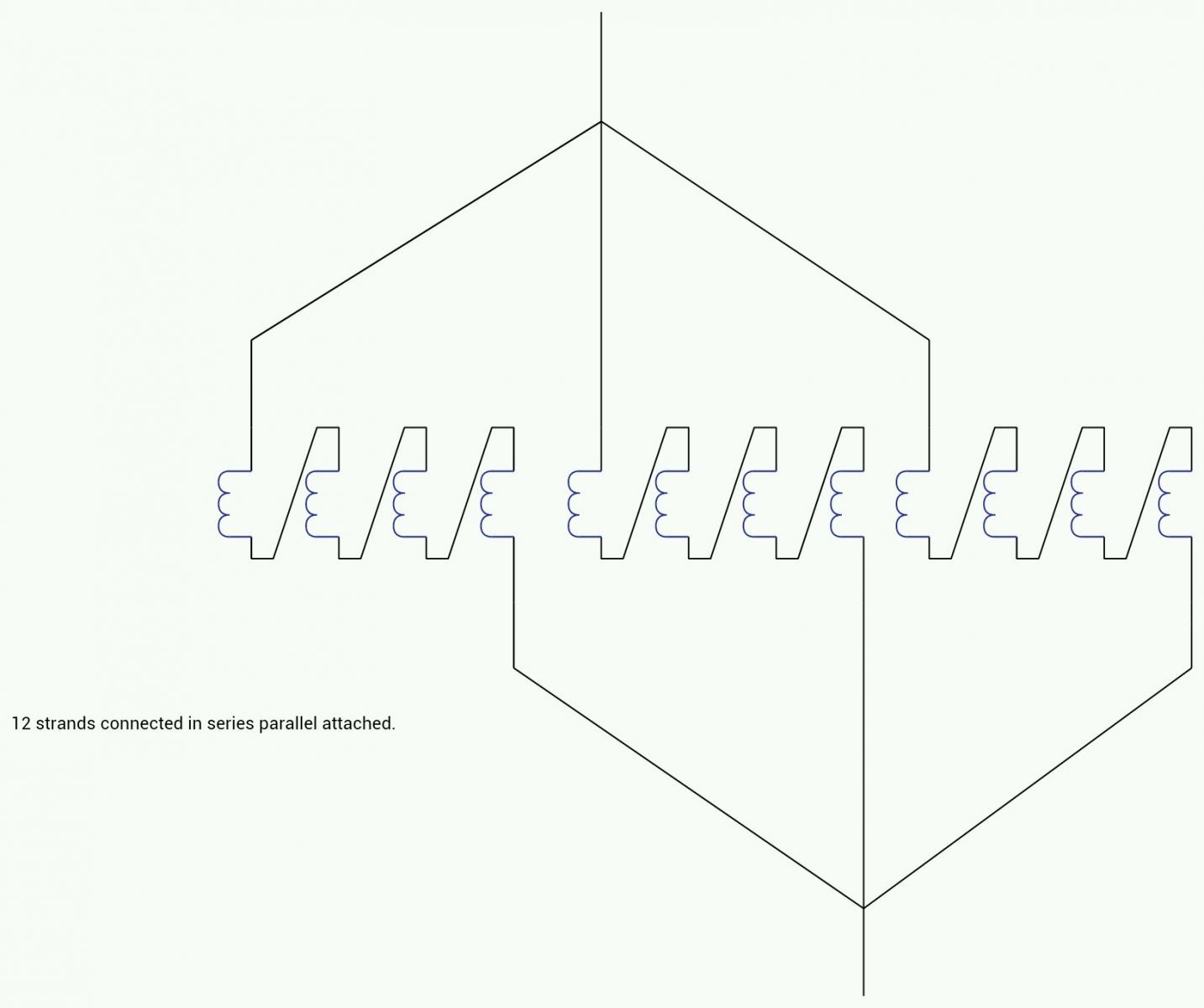

Dave explains better than I can. Here is how I connect in series then parallel.
Was able to get speed up under load. I noticed in your picture you use same connecting bars I do. You may need to try different 2,3,4,or 6 in series like Turion posted.
