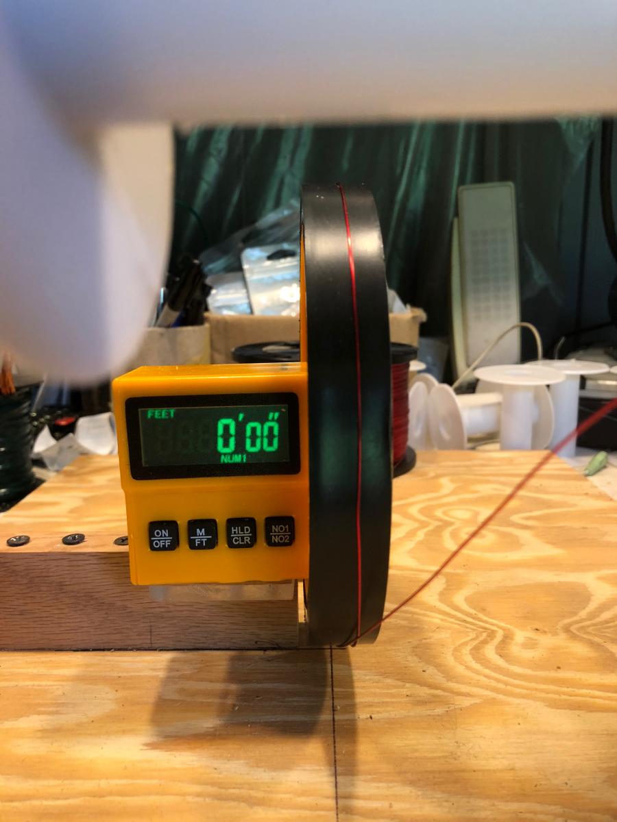

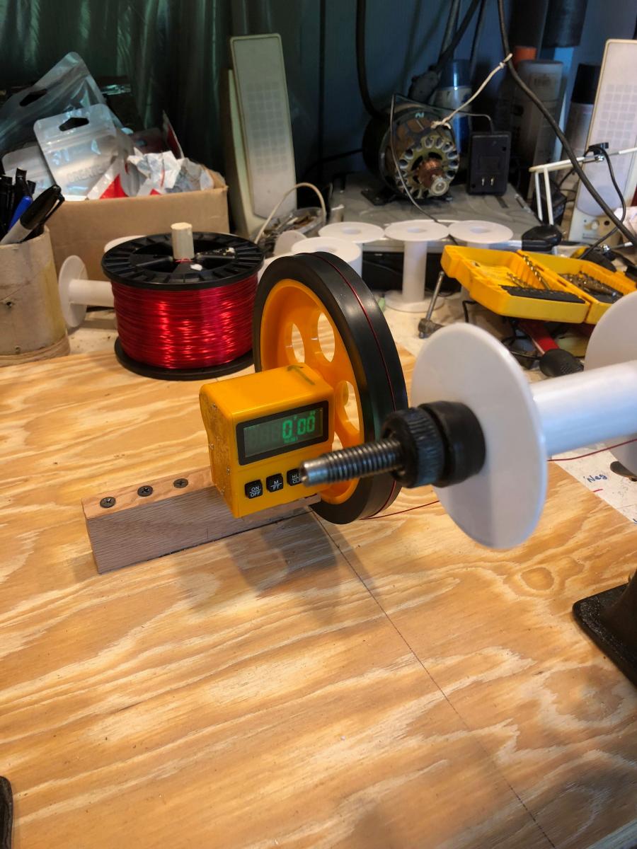

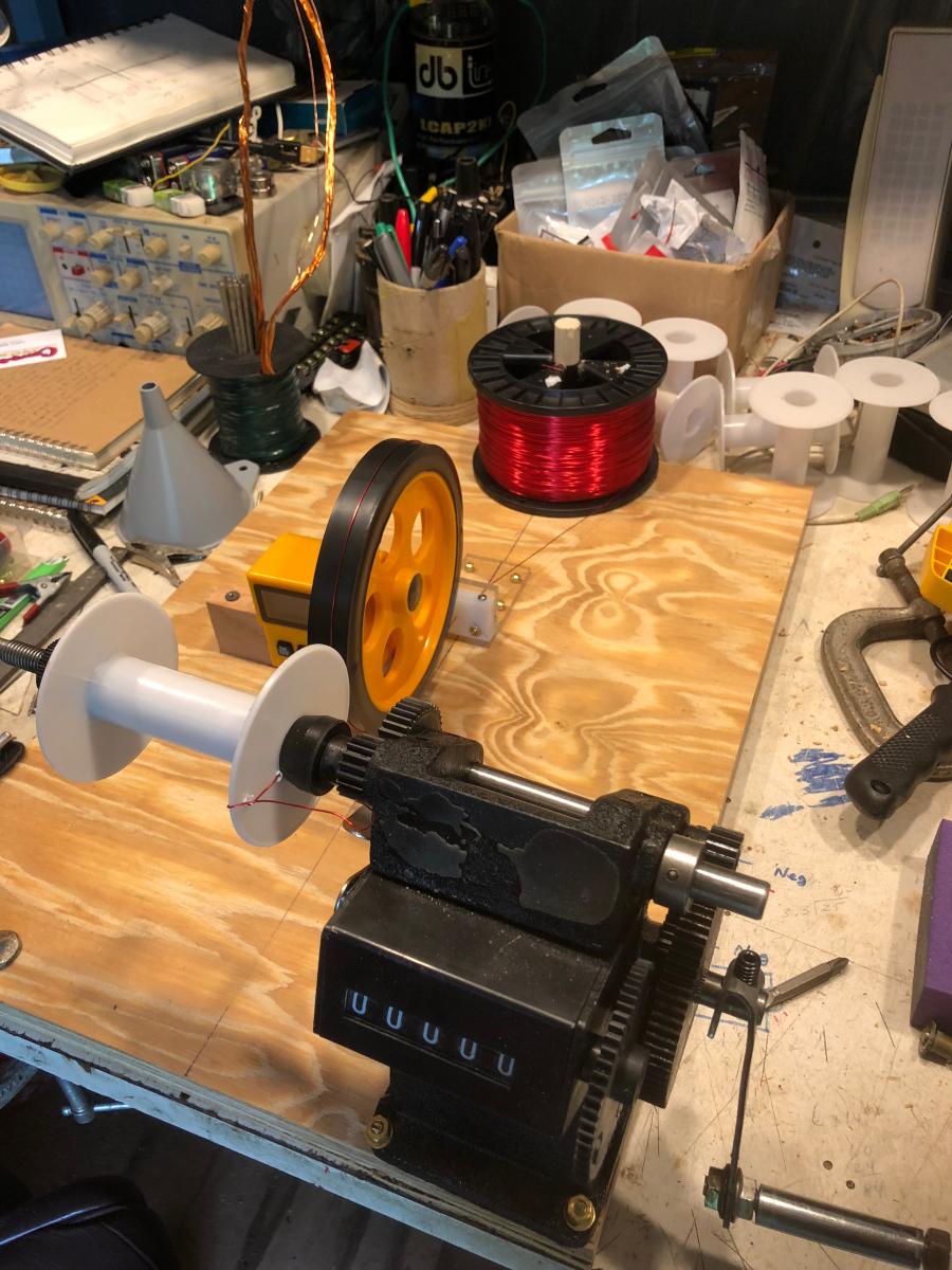

                              Any way here is the pics of the winding machine so far. This is only for the single strand spools (12) with 253 feet each. The measuring wheel is mounted on 1/4" Plexiglas then mounted on piece oak wood. The digital readout is easier for me. I placed the manual winder too close to the wheel, needs more space between them. But was able to wind first spool ok.
                              In the first pic is a guide and two pieces soft plastic to keep tension on the wire. It sits between the large spool and wheel. Tomorrow will place all this on longer piece 3/4" plywood. There will be another guide with same soft plastic between wheel and manual winder. Just needed to see how all the parts would work together. Now I can improve it to work more efficiently.
                              Hope this gives ideas to anyone,
                              wantomake

                              • You will find that the wire wants to slip off your measuring wheel. To keep that from happening as easily, I took some long plastic zip ties and cut both ends off. This left me with plastic strips. I wound these around the wheel on each side and glued them in place. You can build up a few layers and it leaves you with a "track" right down the middle for the wire to run in
