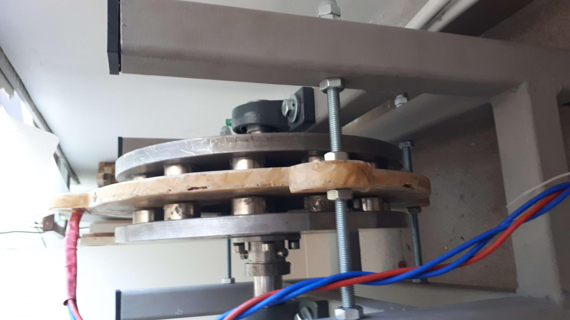

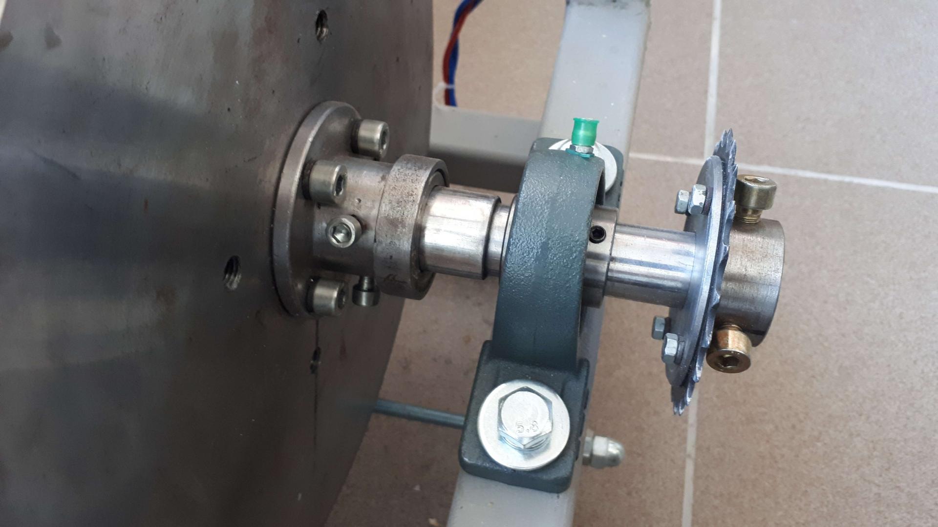

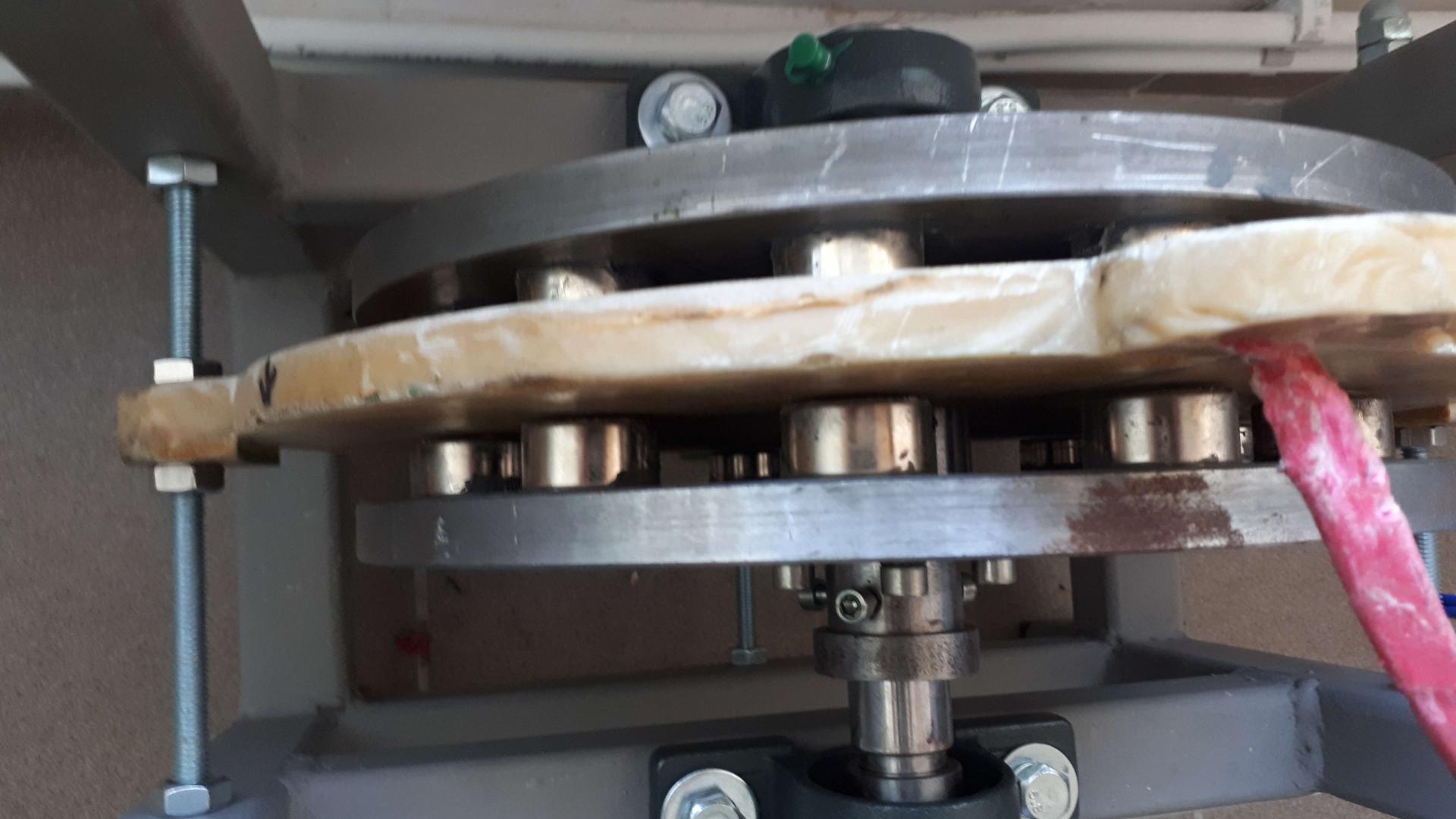

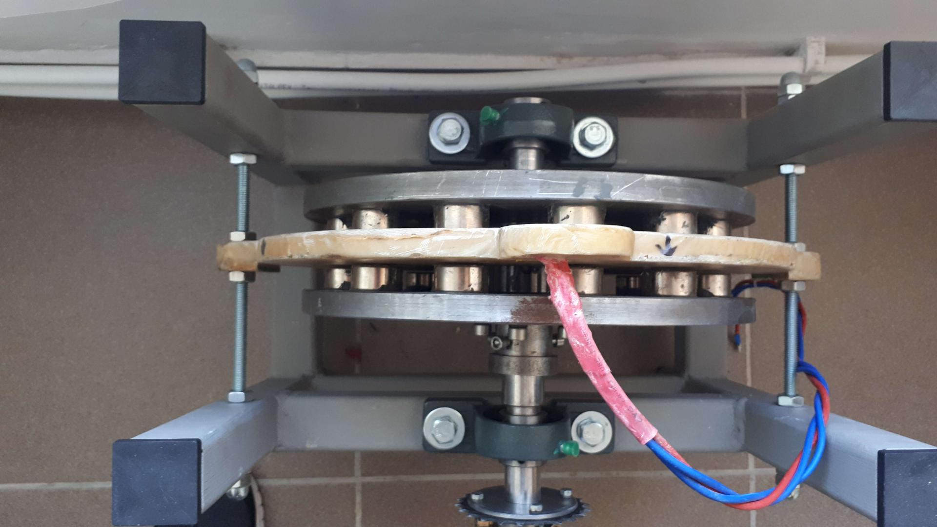

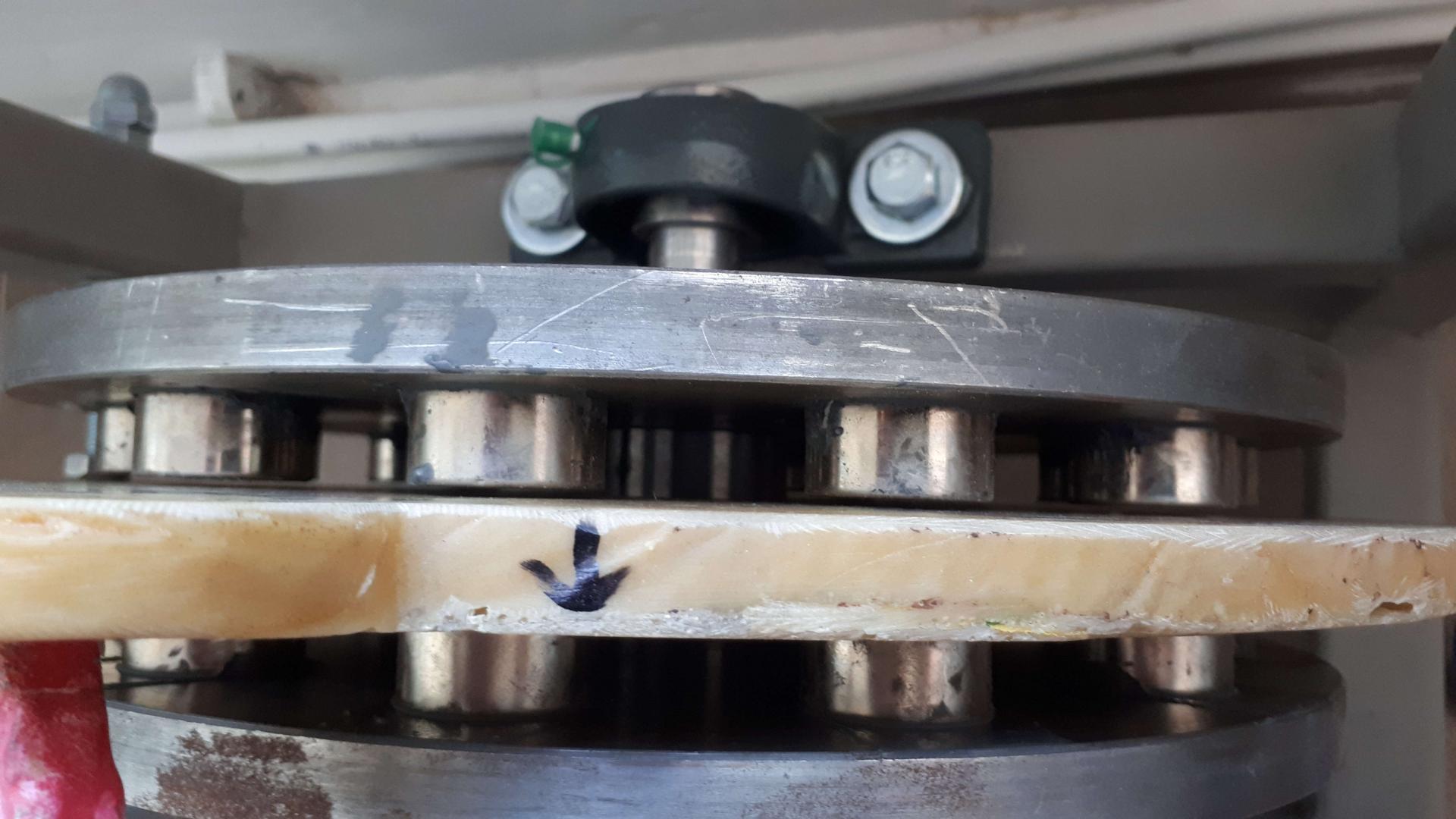

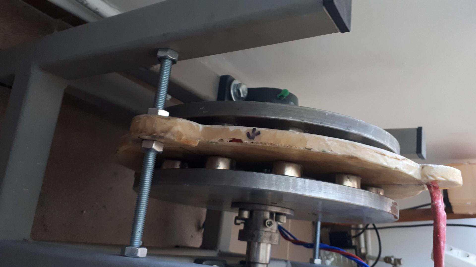

                    Here are some more pictures. There is much to be done on this generator, and soon I as will completely recover from my surgery, I am planning to change the bearings with high speed versions, and to connect the generator to MY1016 motor, at the beginning in stock mode, and after some tests, in Matt / Dave mod. I still have to weld a platform, to make some room for motor...
                    But I have to take care, the disks are quite heavy, and can`t lift more than 7 kg (15 lbs) - not to mention the huge magnet attraction (very, very dangerous). That`s why I will test first with a smaller version, easier to mount and less expensive for copper wires and resin.

                    • Two,
                      If the metal framework you have there is aluminum, you are going to have an issue with rotating magnets/aluminum/eddy currents.
                      Chances are, the magnets on both sides of the coils, as you seem to have, is overkill. The core material will only absorb so much magnetic flux from a passing magnet. One of the reasons why I have built eight different versions of the generator with different rotors and different magnets was to establish what was NEEDED to get max performance. I’ll be interested to hear what your results are.
                      • @Turion,
                        The disks are from 15 mm steel (0,6 inch) and the frame is also made from square pipe steel, so imagine how heavy it is...
                        This is not my invention, I made only some small mods, where it matters Actually, my project was to use this generator for a domestic purpose, but after the surgery, I have to wait a little bit. Actually, a little more.
                        This kind of alternator is usually made for eolian generators, rotor with square or rectangular magnets, and coils wounded in star or triangle connection. I`m quite surprised you don`t know about this.
                        Nevermind, HERE and HERE you can find some good video tutorials about axial flux alternator, and HERE is a translation of a forum I am following for a while. There you have first class info!
                        HERE It`s a video of my generator with a 30 watt car bulb hooked to a trifazic bridge (i think it was 30 watt, I will check later).
                        L.E. - The car light bulb is rated 55/60 Watt, so I think it was hooked up at 55 watt filament. It will be fun to test with both filaments in paralel - 115 watts...
                        There is much more to learn, I don`t know if this is a better solution, but at least this is the path I am going to go, at least for the generator side. I have to test at least 3 different stators, and one of them I think will be just enough for 3BGS system.
