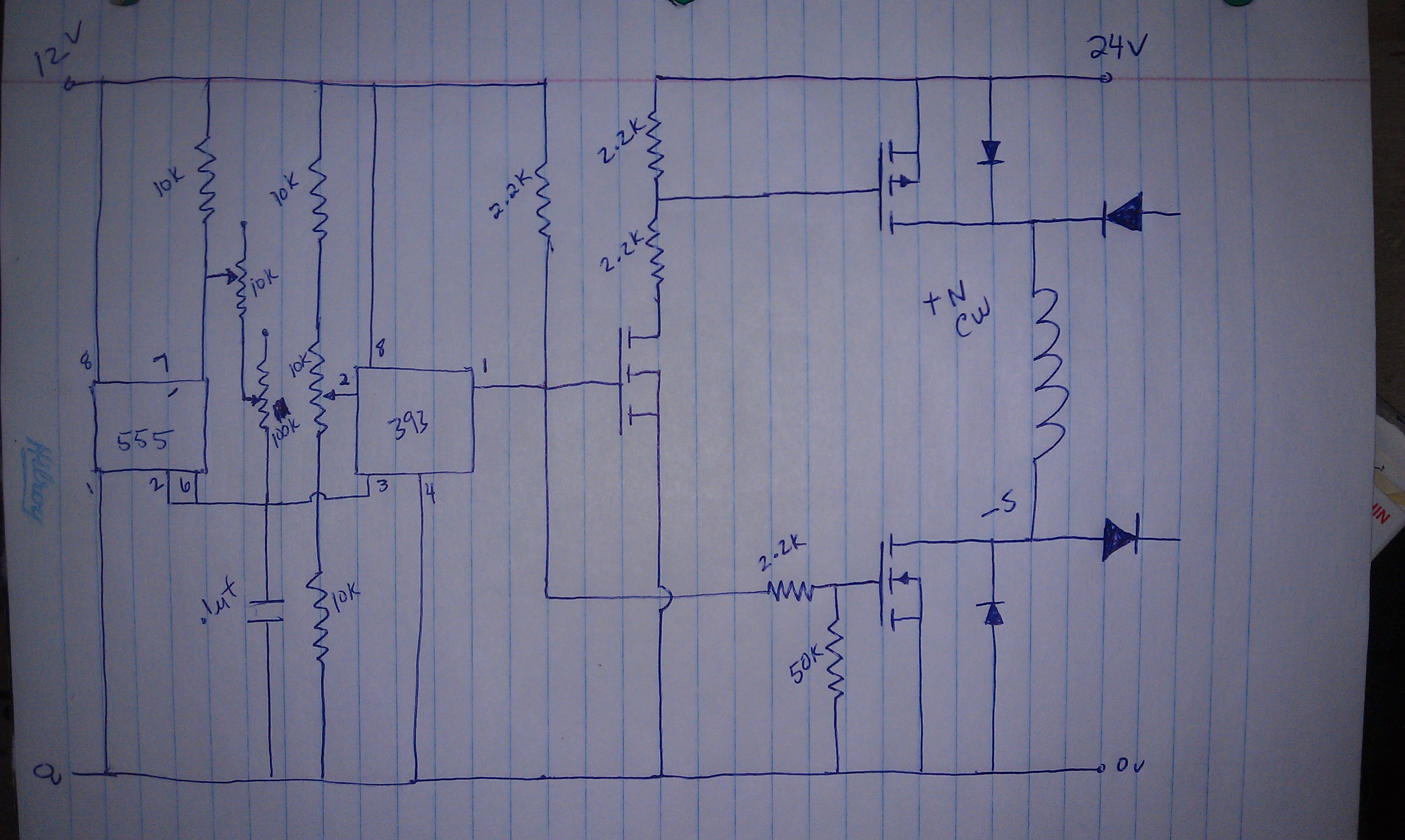

                        • oscillator circuit
                          Hi UFO and everyone,
                          Hey ufo, i havent posted for a while, but ive been working double time, and ive now got a scope, some meters, 15000 ft of 20 ga, hundreds of feet of 33 ga, loads of run motor caps,(find an electrical/motor store for deals on wire)Im gonna start winding a big coil around a frame ive been thinking aboutuess some people are still having trouble with the oscillator?
                          • oscillator
                            sorry,
                            I did not finish or edit that post and sent it.
                            So, i made some videos of some tests, as i was building a dual high low switch. It's based on 555. It is frequency and duty variable. The 555 can be a pain but we are not using the 555 output, the 555 is ringing a capacitor, like the 393 circuit.
                            I'll post the circuit, and then i will try to post the videos of circuit working.

                              @JohnStone, is your sample circuit correct? Shouldn't U3,U4 be identical connected as U1, U2?
                              • thugsugly - YouTube
                                Here are the videos that went with the builds to get a good working dual high low switch. There aere 6, I hope they help some people.
                                I'm using an n-channel to drive the p-channals for high side, because I'm switching more then my signal voltage, and n-channels for low side.
