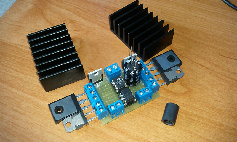

                      I'm working in lm oscillator.
                      It's hard to know what could be happening without inspecting the circuit.
                      It's strange because it has few components.
                      Some steps:
                      Separate circuit parts: lm-oscillator, lm317 regulator, mosfets, coil and pots.
                      In oscillator section take pics and upload, both sides.
                      Power only with 12v battery or psu, no lm317 reg. Measure frequency in output pin 1. Measure freq. in pin 2 and pin 4&6.
                      Extract lm339 and check connections in pcb, measure resistors.
                      Inspect pot's state, measure in ohms, try turning and measure.
                      In lm317 section: Connect to 24v or 36v, check output volts, put a load around to 500mA (30-50 ohms or 5w car bulb) and check volts.
                      Coil: Measure ohms. May be damaged internally. Try other coil you have around with 12v.
                      Mosfets: Try other mosfets (200-400v rated), only one, only 12v. Measure resistors.
                      Good luck
                      http://Cacharreo.com.es/foro
