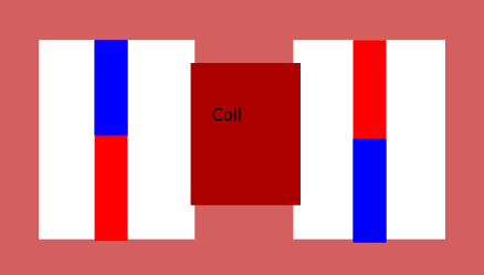

My hybrid
Here is my hybrid concept of the bi-toroidal and the MEG for the simplest generation device ever. one coil, two magnets and three paths of magnetic flow. theoretically you plug it in and it feeds your house power.
PS it's that simple only if it maintains the voltage and only re-enforces the ampsLast edited by Hrothgar; 08-13-2013, 12:49 AM.
