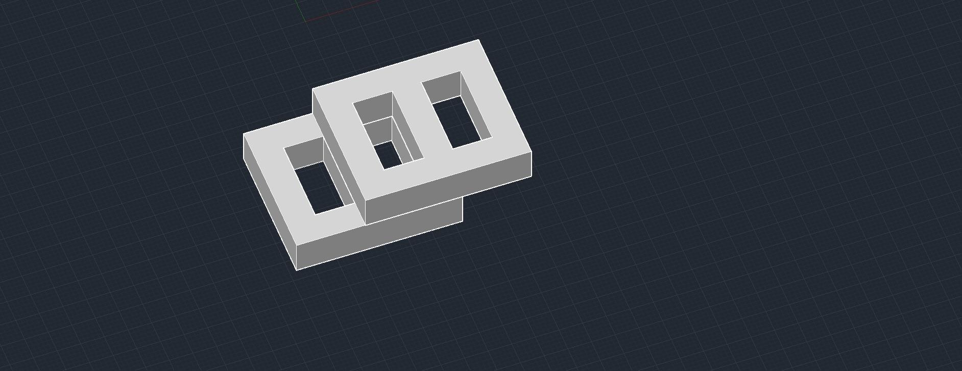

So i had an idea for a bitt. I have a laminated core from a 3 phase transformer. The three legs of the core are equal size. I was thinking of splitting some laminations off and shifting them over so that the first leg would now be narrower and the second two would be the same size as they were to start. The extra would just hang over, unless i cut them off entirely.
Being its a 3ph transformer having equal size legs the laminations can just be shifted. But does it really have to be a 10:1 reluctance ratio? I'm not sure how much power you can pull from a core that size. If i made it 10:1 the primary leg would be 5mm x 30mm. Compared to 30mm x 50mm. I don't really want to build it for mW power. The size of the core is pretty decent(150mm x 50mm). Should be able to make some usable power. Any advice on this idea?
Hi pmazz850,
My understanding on magnetic circuits is that reluctance can be controlled by introducing air gaps with controlled gap sizes i.e. the higher the distance between the facing surface areas the higher the reluctance is. And it makes very little difference when you have a core with a permeability of 100,000 and you make a certain airgap in it and then you have a core with a permeability of 5000 and you introduce the same size air gap: the result is pretty much the same from reluctance point of view (provided the core sizes mechaniclly are much the same for the two cases).
So I do not think you have a drawback right now with not having two cores with much differing permeabilities, you can control rluctance by cleverly choosing air gap distances. Unfortunately you have to be precise to at least 1/10 or 1/5 mm in controlling the gap and the facing surface areas would better be smooth, ideally. Nonmagnetic spacers can be chosen in advance with some thicknesses to keep up with gap control.
Gyula
I just don't understand why if someone was trying to make a very efficient transformer they would want to add air gaps at all. My understanding of the principal is thicker core equals less reluctance just as thicker wire equals less resistance.
Hi zardox,
It is okay what you say, I agree but the reason I mentioned air gap is that by using it cleverly when the cores are not much different in permeability it may help for achieving the phenomena this so called bi-toroid transformer setup is supposed to manifest. I should have written in my previous post that the smaller the air gap introduced the less loss happens. A certain tradeoff is to be chosen when similar permeability cores are used.
Thanks, Gyula
