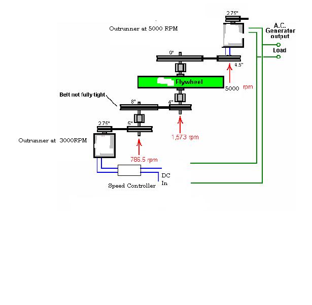

I see the Futaba R/C stuff is in use. I've always wanted to incorporate a flywheel effect Muller type thing into a heli project (gyroscope) but your project Rod is really looking like what I was thinking of
