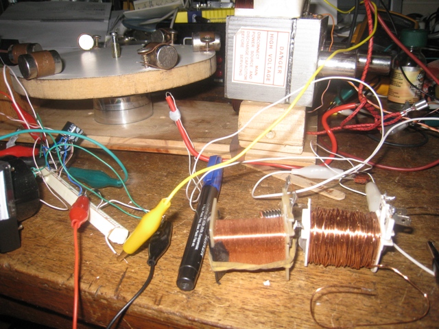

I take a coil from MO fan. I wrapped in the same direction as origianl winding,
approx 200 turns of heavier guage wire.
I biased the origianl core with a ring magnet and washer.
I simply used a reed switch to short the original coil at TDC for max output
from heavier gauge.
The coil on the left is an original - the one on the right is added winding.
Now I am testing with MOT.
