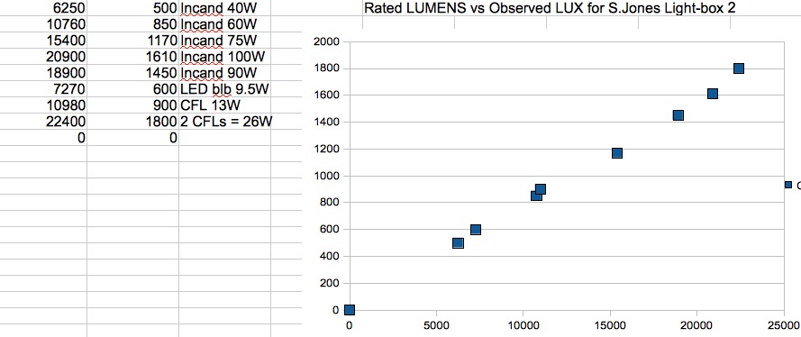

In post #1178, I talked about a simple light-box built for quantitative light-output measurements. Here's more, hopefully helpful.
I've plotted the data points for the calibration of my light-box-2.
The plot shows the linearity of the response in Lux for various Lumens output, with Lumens given on the packaging for each bulb.
The slope of the graph is the conversion factor FOR THIS LIGHT BOX. You should do such a quick plot for each light box you build. For this one, the conversion factor is 0.08(0) Lumens/Lux.
Now I can put an unknown light source in there, such as a bulb during Lynx-Lamp or LaserSaber Joule Ringer testing, and actually measure the Lumens! I will be able to tell if the light is actually getting brighter or dimmer as I change things like the tap on the primary.

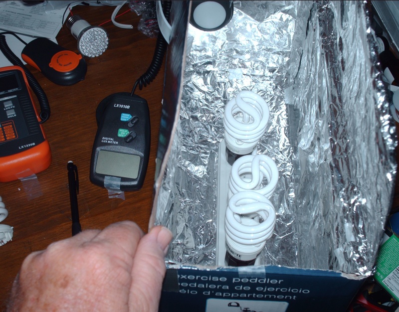

To hand 6 or more bulbs: USE A BIGGER BOX, AND CALIBRATE WITH KNOWN-LUMENS BULBS.
Let me explain further. Take a look at the attached photo with THREE bulbs in it, using a power-strip and plug-in adapters for three bulbs. Everything has to be securely "plugged in" for good electrical contact, and the power-strips should be taped to the bottom of the box so they won't shift around.
For 6 or more bulbs, I would recommend the power-strip approach and use THREE power strips on the bottom of a larger box. Suggest a Xerox-box size or larger, lined with shiny foil on the inside, and easy-to-open lid.
The crucial thing is that you calibrate with the SAME number of light bulbs in the SAME positions as in your test.
And for calibrating, suggest you use known-lumens and wattages to "bracket" what you use on the test. So, you might use 6 40 W bulbs and 6 100 W bulbs, also the same LED bulbs you will use for the test, but run at their RATED volts and watts in (off the grid) in order to calibrate the box for those bulbs. Then do a graph like I did of Lumens (rated) on the y-axis and observed LUX from your meter on the x-axis. Hopefully close to a straight line as I found. (You might want to review my vid and further discussion -- my posts on previous pages.)
Then, with your TEST bulbs, you can measure the Lux and find that on the line -- and trace over to the y-axis to get your Lumens output. With your power input measurement, you can finally divide to get Lumens/Watt, and we can start seeing how well we are doing with various circuit changes and bulbs and so on.
