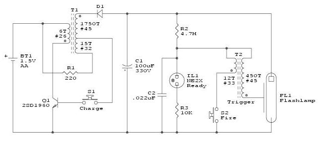

Just fried the transistor on my third Fuji attempt. This one was AA. Was able to find one finally. Someone previously posted that you could not get them anymore. The one I used is a "Presidents Choice" disposable. When I saw them before I decided to do a search on the web. Turned out that they are Fuji's with the Presidents Choice rebranding. So I tried to do the mod that was shown in the video that was posted for me previously in this thread. It is not very clear in the video where you place the leads to the CFL. Also it is important to not break the connection to the neon from where the flash was connected. This was not stressed in the video either. After realizing why the neon would not light and temporarily resolving it, I managed to light the CFL for a couple seconds before the fix came apart. Then after spending a lot of time to secure the neon connection, I could not remember where the leads were supposed to go and shorted something causing sparks and nothing seemed to work anymore. It would be nice if Seth would answer whether the IRF 830 transistors will work with these transformers or not. Guess will just have to buy another camera.

Does anyone have a clear picture or diagram of where the leads are supposed to go on the Fuji circuit ? It would sure help for my next attempt.
