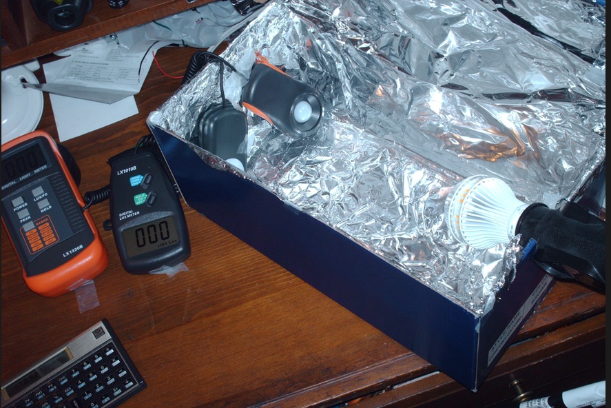

  • Following on the work by Lasersaber, Lidmotor, Peanutbutter and Burgess in particular, my son and I constructed a "light-box" to permit repeatable measurements using TWO light meters -- and a triplet of power and voltage meters to monitor input power. Pls see attached photos from my home
    electronics bench today.
    I found that the meters agree quite well -- one of them is the SAME as used by Lidmotor in vids (orange-color around it). The black one is cheaper on Amazon.
    However -- the meters do not measure LUMENS but rather Lux -- as would be expected actually. (See wiki Lumen (unit) - Wikipedia, the free encyclopedia )
    The difference between the units lumen and lux is that the lux takes into account the area over which the luminous flux is spread. A flux of 1000 lumens, concentrated into an area of one square metre, lights up that square metre with an illuminance of 1000 lux. The same 1000 lumens, spread out over ten square metres, produces a dimmer illuminance of only 100 lux. Mathematically, 1 lx = 1 lm/m2.
    A source radiating a power of one watt of light in the color for which the eye is most efficient (a wavelength of 555 nm, in the green region of the optical spectrum) has luminous flux of 683 lumens. So a lumen represents at least 1/683 watts of visible light power, depending on the spectral distribution.
    So we have to be cautious regarding colors, also the difference between lux measured on the meters and lumens.
    So I ran various "bulbs" in the box and kept track of the input voltage, input power via two meters, and lux via the two light meters. As long as the bulbs were designed to put out light more-or-less isotropically (in all directions -- not beam-like), I found a GOOD correlation in my box between lumens and the measured lux on the meters.
    That is -- I assumed the lumens as listed on the packaging with each bulb is reasonably accurate. I found that the voltage in town varies from about 117 VAC -- then the power on the meters agrees well with the rated power on the bulb -- and about 124.7 VAC. The lux meters show a sharp RISE in output lux when the voltage in town jumps UP. (I was surprised the voltage varies so much... good thing I'm keeping track of it! so I can make sense of my readings.)
    So, when the power for a 40 W bulb showed 42.5 W with the higher voltage, I made two separate measurements of lux output, and I assume the given lumens output scales roughly linearly for a small change in input voltage.
    Likewise for the various bulbs, 90W, 100W incandescent; 13 W fluorescent; and 9.5 W LED bulb.
    I found that to within a few percent, I could find a conversion factor between what I read on the flux meters IN THE LIGHT BOX and lumens as given on the packaging! That is, I was able to calibrate the light-box-plus-light-meters system. Without given all the data here (tedious, its all in my logbook) -- here is the conversion:
    Lumens = 0.059 * Lux (+/- about 7% with the various measurements involved) with my light-box.
    This is actually the value using just the top watt-volts-kW-hour meter (it is cheaper and I like the increased digits for kW-hours) AND the cheaper black light-meter. The conversion factor found by averaging both power-meters, and also averaging the light meters is about the same, so I'm simplifying measurements by focusing on two meters, one for input power and one for output light. (But I do have redundancy to check things; part of my scientific training I guess... )
    I would be leary of using this system to try to establish ou, there are more reliable measurements IMO, but -- this is a very interesting way to compare lumens/watt for various bulbs AND for various circuits -- like the SJR -- for the same bulb.
    Peanutbutter and Burgess pls note -- one may get more lumens/watt (Lm/W) due to higher frequencies in the output circuit, for example; that is, higher Lm/W does not NECESSARILY MEAN that you are getting more POWER in the output circuit, it may just be there is more efficient light -output than is rated on the bulb for 60 Hz.

            • I posted further information regarding light-box analysis on the "Joule Lamp" thread; posting here for convenience of researchers.
              Congratulations, Lynx! indeed its time for lumens/watt testing.Let me see if I can explain how easy this really is, how I'm going about it. I would like to do these measurements, but I'm way behind you on the builds (you are fast!), so I'm going to encourage you (and all) to build a simple light box. Here's the vid I put up just now:
              2LightBoxCalibration.mov - YouTube
              Vid shows the "light box" I put together with my son today for these devices and how it is calibrated.
              We first take one bulb of KNOWN lumens output, specified on the package and place the bulb in the light box. (I use the middle position on the power strip as seen in the video.) Turn the bulb on. We note the lux as measured by the light/ lux meter. We check that the Watts-input is close to that specified for the bulb (on the package again).
              The package on this CFL bulb says it puts out 900 Lumens (Lm) running at 13W.
              I find with repeated measurements -- when the CFL bulb has warmed up -- the light output is 10920 Lux (average). Then, I divide:
              900 Lumens/10920 Lux = 0.082 Lm/Lux.
              I repeated this calibration for an LED light, 600 Lumens running at 9.5 W is seen from the Light Box as 7280 Lux, again 0.082 Lm/Lux for this light box. (Each light box will have its own conversion factor, Lm/Lux, which can be calibrated in just this way.)
              Repeated for a 60 W bulb, 850 Lm / 10760 lux observed = 0.079 Lm/Lux.
              Repeated for a 40 W, 75 W, 90 W and 100 W incandescent bulbs also, the average is about 0.080 Lm/Lux +/- approx 6%.
              You can just use 3-4 light bulbs for calibration. Close enough to really help us in this research!
              _____
              So I put in a second bulb (done with incandescent and CFL) in the front position, and got very close to the same 0.080 conversion factor. That is, the second bulb DOUBLED (very close) the lux light output on the meter. When I put a bulb in the back position (near the switch on the power strip), the conversion factor was about 0.085 showing that a bulb in this position gives a non-linear response; which is OK with this separate calibration for the two bulbs in these positions.
              For three CFL bulbs, in the three positions with adapters as seen in the vid, I found:
              2700 Lumens / 29600 Lux on the meter = 0.091
              (a larger conversion factor as I expected, because less lux reaching the light meter with three bulbs in this configuration)
              ____________
              Now that the box has been calibrated, we can place an UNKNOWN light source into the box in the same spot, or two or three light sources in the locations described, and measure the light output in Lux on the meter. Then,
              Lumens output = 0.08 * Lux (for one bulb,as read on the meter).
              For more bulbs, would use the appropriate calibration factor we have determined... Easy!
              Finally, we determine the input power (if from a battery and DC, P = I*V, current times voltage), and calculate Lumens-out per Watts input -- Lm/W.
              The idea is to MAXIMIZE Lm/W in various test devices, such as Lasersaber's SJR 2.0, and Lynxsteam's Teslamp. (Great work, gentlemen!) I strongly recommend use of a light box for quantitative measurements of Lumens-out/Watts-in so we can make solid scientific progress.
              For comparison, we calculate a few known values from bulb packages:
              Incandescent, e.g., 850 Lm for 60W bulb => 14 Lm/W
              Fluorescent, CFL, e.g. 900 Lm for 13 W bulb => 69 Lm/W
              LED, e.g., 600 Lm for 9.5 W bulb => 63 Lm/W.
              I strongly recommend use of a light box for quantitative measurements.
              A value above 100 Lm/W would be very interesting! Let's see what we can come up with.
