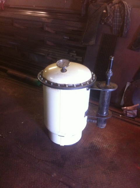

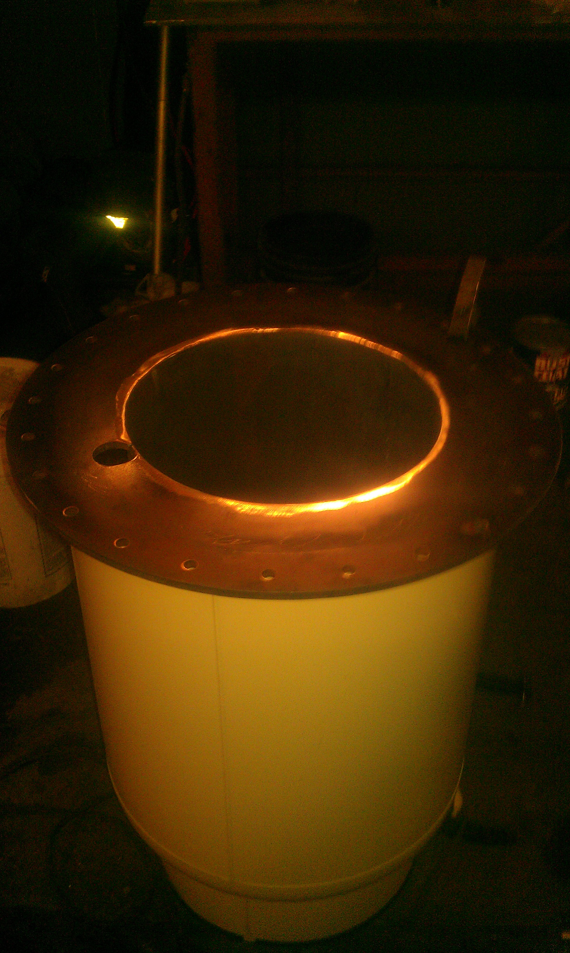

            Hello, My name is Scott, I have a business in Alberta Canada, hauling crude oil aswell as modifying shipping containers in out welding shop. I have been heating my shop for several years with waste motor oil, and have a good supply from other companies in town. Only catch is I have to take the plastic oil pails aswell as oil filters. So I had to build a reactor large enough to fit a pail inside. This one has a capacity of approx 40 litres, and a tall oil pail will fit in the reactor nicely. Where my design differs from all of yours is how the gas is routed from the reactor. I did not want the line running from the cover as it would be an extra step to detach it every time I open it. So I decided to run the pipe from the bottom flange around the bottom of the reactor where it will come into contact with the flame again and allow any fluid from the refracor to drip back to a hot area and recrack. The upper flange ( on the cover ) has a larger opening so to allow the gasses to enter the 1.5'' hole in the lower flange. Still much to do, but here are my pics so far.
