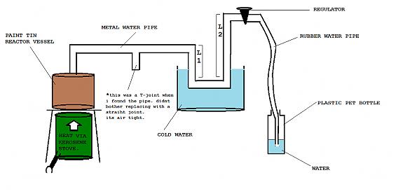

hi jetijs,
first of massive thanks for sharing your idea of turning plastic into fuel.ive been reading ur post for a few weeks now.i really liked it. and i m so looking forward to buid a plant just like urs too. so i tried a small model of ur plant just to start out and to have an idea before i really build a big plant like urs. but unfortunately, i m having some problems and cant figure out where i went wrong.i know that u hate repeating urself so i even read the whole thread but still i cant figure out why my model is not working.the problem is that the vapour is not coming out.
i have attached a diagram of my model.
i used a 5 litre tin ( paint bucket tin) for my reactor and packed it with polyethene bags( around 1 kg ).for the heat i used a kerosene stove. i tried to keep it very simply just to check if it works. there is only one pipe coming out from the reactor which passes through the cold water in a bucket and the end of the pipe has a regulator and from the regulator i connected a rubber pipe whose end is dipped into the water in a pet bottle. the bottle is not closed.
i supposed the vapour will pass through the pipes and when it comes in contact with the water in the bottle, it should condense and float on top of the water. but for some reason the vapour is just not coming out.
i tried closing the regulator for some time and then opening again but only a few bubbles which wasnt fuel but just air.
i kept the process going for 4 hours but still nothing.
when i shake the reactor i can hear the splashes, the plastic has turned into liquid as thin as water.when nothing happened i stopped and quickly opened the reactor, the liquid was boiling and there was so much vapour too but it wasnt just passing throug the pipe.
would u mind plz correcting me where i went wrong? because i really want to get this system going.
i was thinking is because the length of the pipe L1 is shorter than L2( as i have indicated in the attached diagram) .w was wondering is it because of this when the vapor reaches the horizontal area betn L1 and L2 it changes into liquid but flows back through L1 into the reactor because L1 is shorter?
or, is it because i dont have a condenser? i really dont know if a condenser is required to suck out the vapour too or is the condenser just for cooling.
please let me know where i went wrong. i would really appreciate if you could.
thanks.
jenish.
jenish14,
why did you use those vertical pipes at all? If liquid will condense between those pipes on the lowest part, it will somewhat block the free vapor flow. Also, is the pipe coming off the reactor getting hot? If not, then your problem is not enough insulartion of the reactor, the top part is just too cold and everything condenses in the reactor already. The reactor output pipe should go only horizontally and to the bottom till the condenser, so that everything that condenses collects in a cooled reservoir and so that the condensed liquid does not create blockades in the pipes. what temperatures? You should have started with the temperature readings, this would clear a lot of things. Don't use any regulators, you don't want to create any unneeded pressures inside the system.It's better to wear off by working than to rust by doing nothing.
the attached picture should help.
The whole reactor should be insulated, the outlet pipe can be uninsulated. It the pipe does not become hot when the reactor is already hot, then the vapors are not passing through, so ether too low temperatures, or not enough insulation. After the outlet pipe you just need to cool the vapors, you can simply connect the pipe to a reservoir and put this reservoir in a bigger bucket filled with water. Or use whatever cooling method you have available.It's better to wear off by working than to rust by doing nothing.
