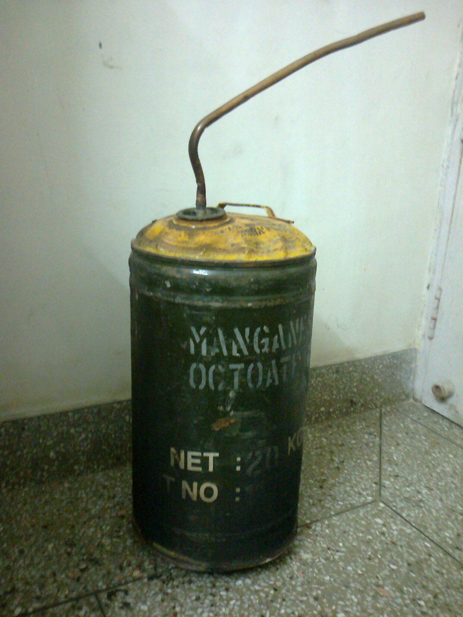

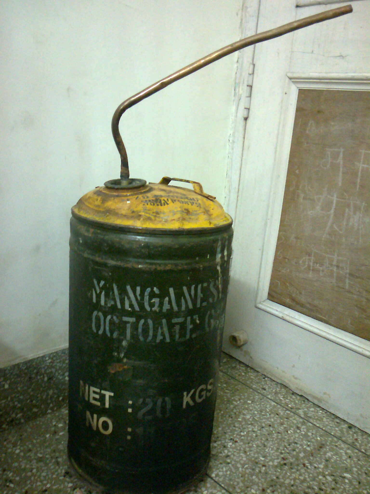

1) Time to heat you reactor largely depends on the Size of your reactor & the heating method you employ.
On top of it which metal U fabricate your reactor ???
This week I made a new small lab-scale puro unit of 10-Liter capacity only.
I used Stainless steel Not mild steel for fabricating the reactor .
It took half the time to heat-Up the plastic than a Mild/Steel one .
