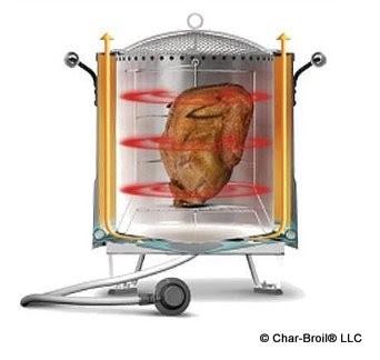

                        • turkey cooker
                          hello all - everyone here is so helpful and willing to help others - i am glad to have found this place. i am planning on making a ~3 gallon reactor.
                          there are many turkey cookers in US - most are just a pot on a burner. I found this type. Char-Broil | The Big Easy® they are available used for less than $50 US. I figure it will save cost using something already built. I plan on replacing the stainless steel insert can with a thicker-wall reactor (like 5 gal propane tank etc)
                          This type has a burner ring around the bottom where the hot gases flow in a double wall. I am thinking it will work with added insulation.
                          What are the thoughts on using this ?

                              • Turkey pot is my type of engineering-eagerly await your report!
