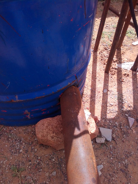

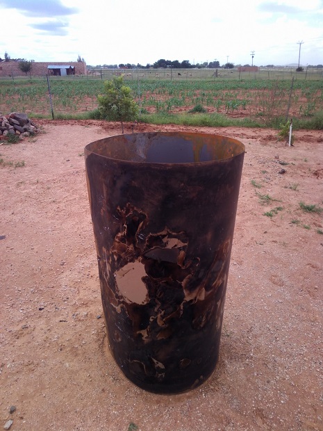

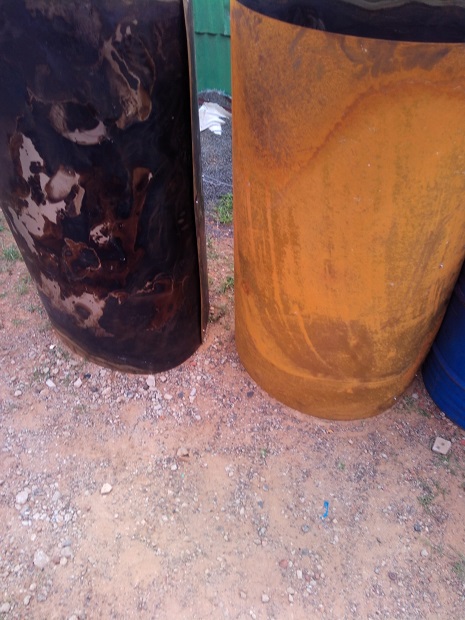

    Thinking safety, I decided to post pics of my retort and failed flame ducting. The retort is OK apart from the scaly look which does come off with a wire brush. The flame ducting took a beating and collapsed, flooding the flame area with vermiculite. The steel duct looks very crystallized.
    I'm considering cutting some .3 -.4m off the retort bottom not so much because the steel isn't good but because I think some greater distance between burner and retort would reduce the heat pounding. Possibly some kind of sacrificial brick or steel structure could take the brunt of the heat. In addition some sacrificial wear plates may be added to the retort.
    The thought with this mod is to convert the flame zone into something more like an oven, instead of being like a blow torch.
    Flakey retort mill scale. This steel flakes presumably from heat oxidizing the metal.
    Ducting for flame from burner head. Pipe crumbled in flakes a bit like rust.
    The ducting will be replaced with refractory bricks.
    I'm pondering the options so please post with similar stories, pics or just a comment. HTH

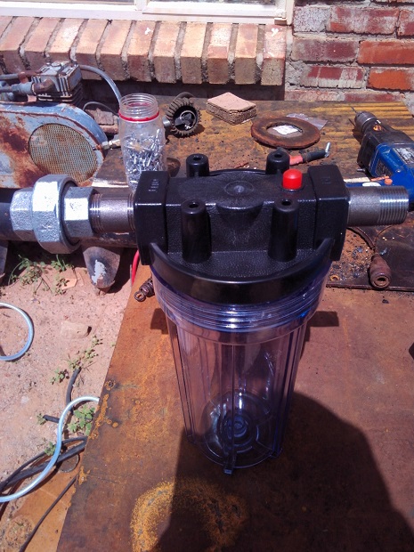

    Hi Excalibur
    It is good to get pics of failures too. Nothing is really a failure as long as we learn from the experience. This is a good way to go to share with others, what works and what not, what to watch out for. How thick was the steel you used on the ducting?
    I looked at your gas jar and decided that I will do something similar for the gas storage. Is it necessary to have the water tank open, won`t a water level work just as well to inform you where the gas level is in your storage tanks?

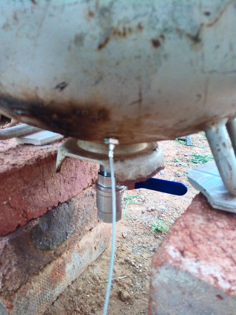

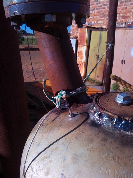

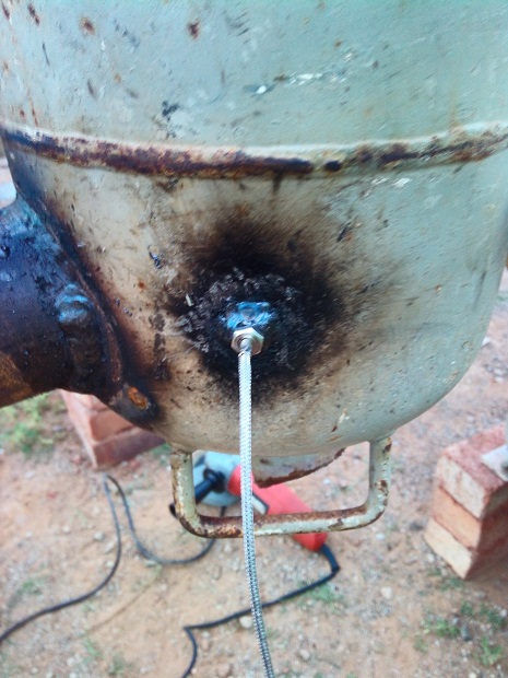

            • I will be testing the use of 3 TC's in the retort, one above the reflux and one in the diesel tank.
              I have welded a pipe to the base of the retort to make a thermowell for the first TC. The pipe will extend out through and past the insulation. This TC will monitor the temperature of the retort floor so I know what temperatures the oil is exposed to, and I should see a spike in this temperature when boil-dry is achieved.
              The next two TC's are located in the belly of the retort, suspended from the ceiling. I have bent a return into the end of them so there will be no dripping of condensed vapours down past the end of the TC affecting the readings, they point upward. They are removable as they slide through a stainless steel compression fitting then are screwed into a bush and screwed into a socket large enough for the bend to fit through. I intend one to be located 150mm off the floor and the other 300mm off the floor. The retort is 600mm tall. I hope TC #2 and #3 will show slightly different temperatures as the oil level rises and falls, allowing the oil feed rate to be adjusted as necessary. I realise a 'rolling broth' in the retort could make registering temperature differences difficult. If so, then I will trial a cage / baffles of some kind around the TC in an attempt to keep the foam out and let the liquid in / out. Failing this, thermowells should work because the bubbles would transfer less heat and less efficiently than the liquid. Though it would be the same as if there were no cage or baffles or thermowell wouldn't it, just a delayed reading? Has anyone had success / failure with compression fittings on the retort?

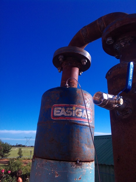

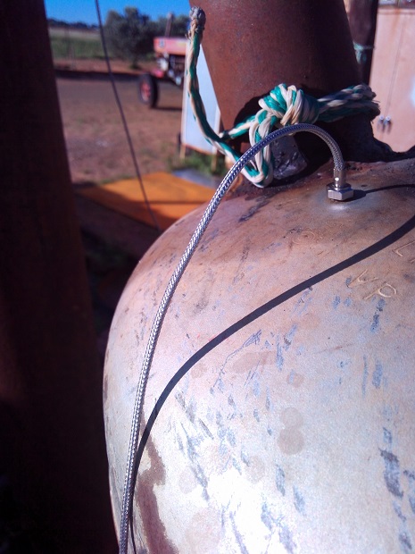

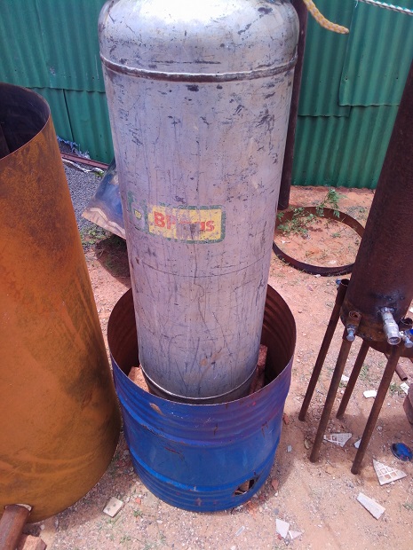

                • Here is some pictures of all the probes installed, I was wondering what I should use to make a tight seal from gas leakage that can take the heat.
                  Maybe gasket sealer silicone? Or will the temps on the reactor melt that away?

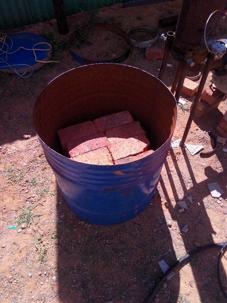

                  • My Molds for the insulation from silicate jell and perlite mix, In will be poured in and stamped tightly between the inner liner and outer liner, set to dry and then released. Obviously the bricks will be removed and legs attached to the reactor that will support it and take the heat at the bottom. It will need to be strong enough to endure the heat from the burner.

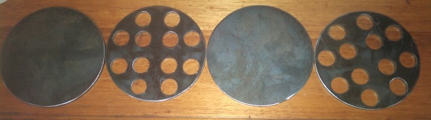

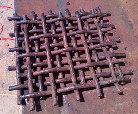

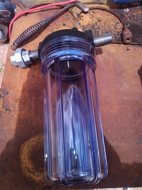

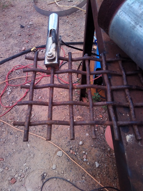

                    • The water bubbler I`m going to use, from here the gas will go to the gas jar as in Excalibur`s Design.
                      Also some pics off the heat exchanger with the water inlet and outlet installed.
                      The grid for the reflux column that will support the metals shavings and the catalyst.

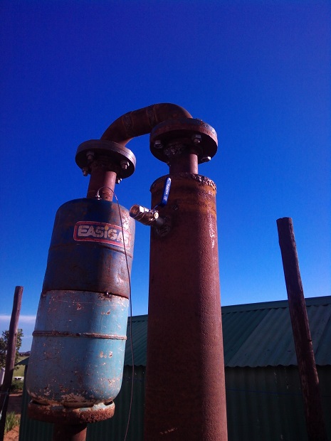

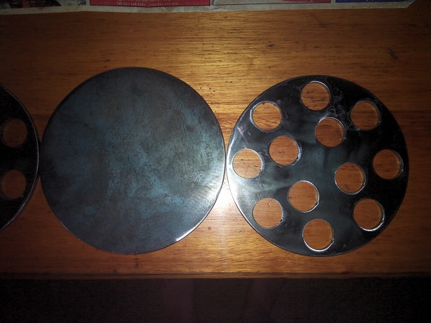

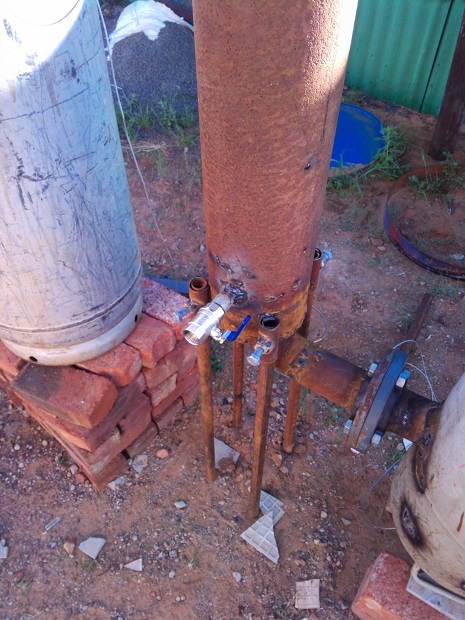

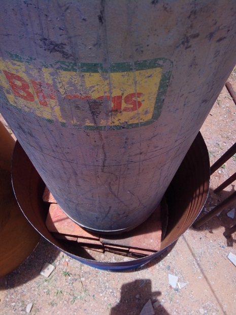

                      • The complete systems as to date without the mold and the water bubbler. I will install the water bubbler this afternoon and weld close the reflux after installing the grid. Maybe I will even include some photos with the mold covering the machine.
                        This system is small and easy to build with everyday material that anyone can get anywhere in the world, maybe only the see through water bubbler will be a problem, but the rest is easy to come by.
                        I don`t know how long the reactor will last as it is made from a 48kg gas cylinder, the walls is not really thick, between 2mm and 3mm thick, I won`t want to run this for a very long time. How long do you think a person can risk using such a thin reactor with it staying save?
                        The feeding tube that has warped from the heat, instead of sanding it I will just remove it and put on a new lid from a solid peace of steel I will cut with my plasma cutter. It was just the top lid that has warped as I welded on a peace of metal to close the hole in the flange to seal it. The ropes is there currently just as support until all the containers have there own legs welded on.
                        My Low tech plasma cutter jig for the hole cutting. Made from a piece of wire bend according to the length I need for the hole.

                        • Originally posted by VAST View Post
                          Yes the Silicon will melt. Exhaust Cement is better.
                          What's the rope around the pipe for? It will melt aslo.
                          The Steel casing around the Retort may need to be insulated as too much heat will escape outside. You want all that heat radiating into the Retort.
                          Also, paint the retort and the drum with an HT exhaust/Engine paint, or the paint they use on Pot Belly stoves. This will reduce the corrosion from the flame on the steel.
                          Keep an eye on all the Valves. They all have plastic seals and if they get too got, will leak.
                          It's really hard to get your head around the fact that the Liquid can be anywhere from 300 to maybe 500dgC. When something starts to fail, you can't just turn it all off with the flick of a switch. You end up standing there watching something melt not being able to do anything about it.
                          Not a biggy, but I think you have too many distillation vessels. I figure that most of the fractions are going to be cooled enough to condensate in the ver first container. I would look at insulating the first container to allow only heavy fractions to accumulate there and the lighter ones to move on to the next. Even insulating two container and the last water cool perhaps. That will separate even more weights of fuel.

                              Just for your information as to the insulation. Silica Gel and perlite mixture = insulation.
                              Correction, my mistake. I`m talking about silicate gel while it is actually sodium silicate or "water glass".
                              Another video about how to make your own silicate sodium.
