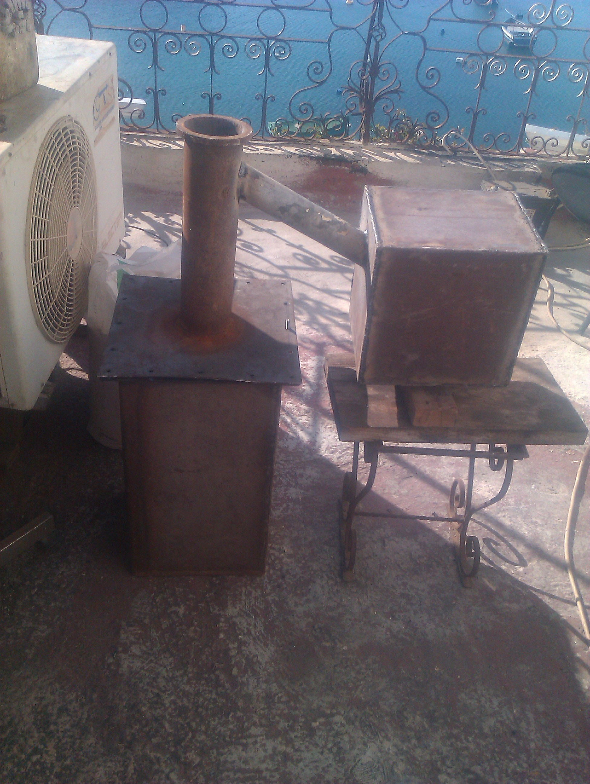

this is my pyrolysis design retort,reflux and lst condensor l am going to do another condensor and bubbler if some one can help me? my question is to purge the system what l can do? l read that l can put some water in retort? thanksAttached Files

Hi Jonathan,Originally posted by jonathan View Postthis is my pyrolysis design retort,reflux and lst condensor l am going to do another condensor and bubbler if some one can help me? my question is to purge the system what l can do? l read that l can put some water in retort? thanks
Where are you located ? - Looks beautiful wherever you are!

The easiest thing to do in my opinion is obtain some CO2 or nitrogen and use it as a purge gas.Originally posted by jonathan View Postthanks for help nice pump in malta its dificult to find pumps like that l buy my temp controller and sensor from ebay
I welded a small diameter pipe coming off the bottom of my retort and then attached a hose barb to that using a coupler.
Make sure your small diameter pipe is sufficiently long if you're using a rubber/silicone hose for your gas. I had to extend mine because the hose began melting.
retort,reflux,condensor
l cant buy that type of gas l try to buy he tell me that l want license to buy co2 or nitrogen l try to find compresure so wwhat l want to do? first start compresor start retort and leave compresor on? can l use compresor from air compresor?Last edited by jonathan; 05-01-2013, 11:16 AM.
Most compressors pumps used in air compressors cannot be used as vacuum pumps. Since you cannot get CO2, and a diaphragm vacuum/compressor pump is not available to you, then put water into your retort with whatever you plan to crack before you turn it on. The water will displace O2, and as long as your pyrolysis unit is leak-free, then it should operate safely.I have been running various blends of waste oils and unleaded gasoline in a 1983 Chevy G-20 van with a 6.2L diesel V-8 engine, with a Stanadyne Rotary DB2 IP since Feb, 2007. I have started the engine with no difficulty and no block heater on an 80/20 (WVO/gas) blend down to 0F (-18c). I have found that by blending as little as 15% gasoline in the summer, and as much as 50% in the winter, my engine starts and runs as if it was running on diesel fuel.
