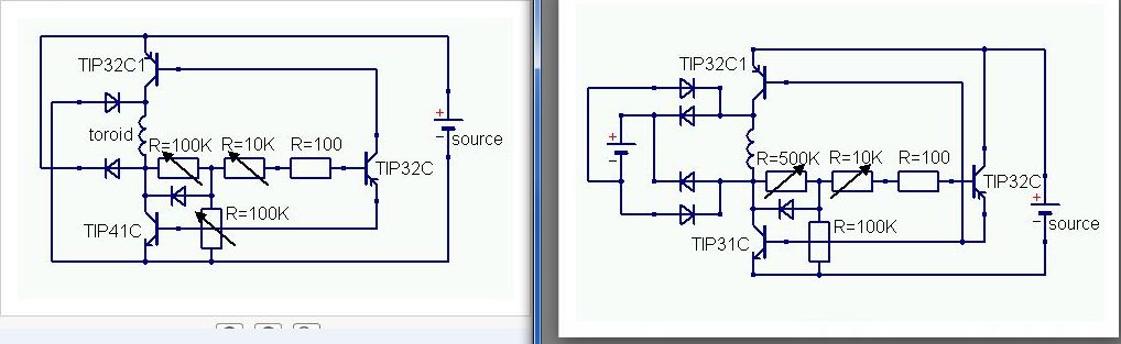

Sucahyo, i do not know why two 32 circuit does not work, but i tried
today different combinations with two tip 32 with bingo too, and
it does not work too...I tried that cascade (base of first 32 to collector
of second, emitters on positive, but the problem is where to connect
collector of one of the 32)...
If both collectors(or even one collector and
one emitter) go to base of tip 31 it does not work at all, and if i put
one of the collector/emitter to the negative than i got some result, but
bad result, and if i connect it to the collector of tip 31 that is the only
combination that works, but with less efficiency than in normal combination...
So, i really dont know how you do it...

, my mistake, the right picture is wrong. The second PNP collector should connect to the first PNP base.
