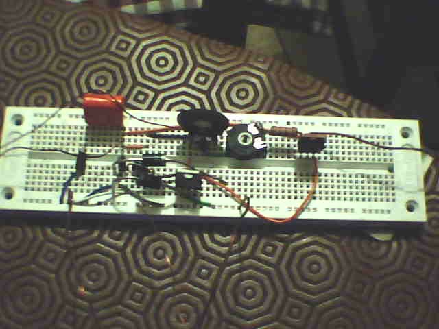

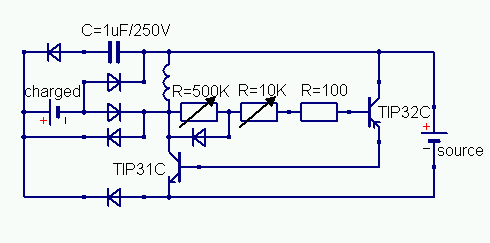

when i switched PNP in reverse mode ?...I left that one stingo like that
(in reverse mode), but since it is 6 a.m. here, i soon go to sleep (who
normal goes to sleep in that time ?..no one !) so i am going to search
this thing today after a little bit of sleep...But, while i am still awake
i have to ask you how come that i noticed in fact opposite effect than
what you just wrote :
In my last post i just explained that there is more consumption of
current with reverse mode, and you said total different thing :
2,2 times less consumption of current...
Help me to become sober after this confrontation of opposite notations !
Maybe some hints could help...
And final question : how come your schematics are not in reverse mode ?
