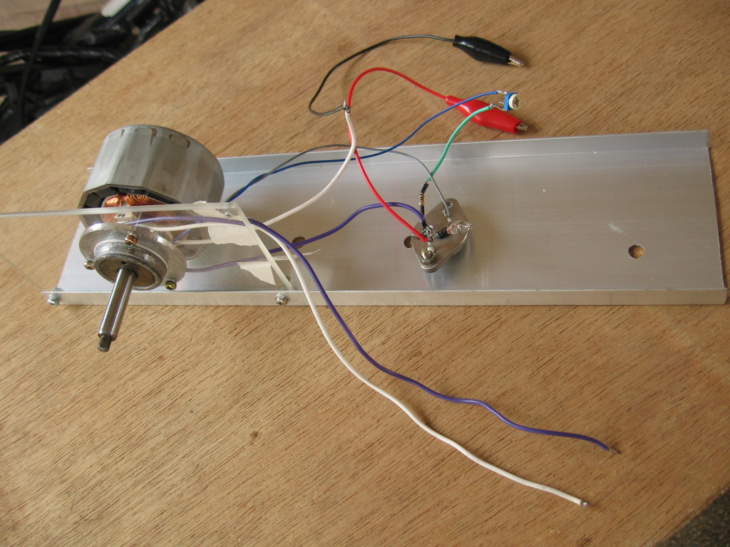

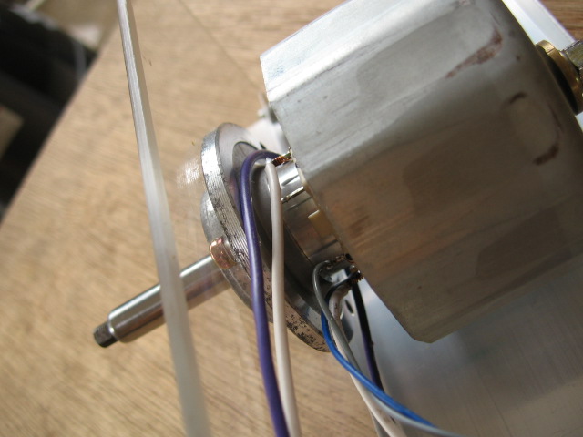

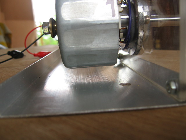

                        • #27
                          citfta,
                          thanks for the link...
                          meanwhile here are some pics of my motor NOW... those 2 unconnected wires is for the OTHER set of coil(for slave) regarding the aluminum baseplate, I dont mind the "Eddy current" , rotor magnet/case is about 10mm farther from base so I dont worry too much... those wires with alligator clips are for the charging...and YES I have a trimmer (1k) in series with 100ohms... still need another DMM if I have to monitor both input and output charging current
                          EDIT:
                          Image:Increased Volts.JPG - PESWiki
                          so THAT is HOW it should have been.. now its all clear to me..
                          EDIT2:
                          I was wondering, w/c circuit is better for a self-runner? the SSG or the 3 transistor version? (pnp-npn on main coil)
