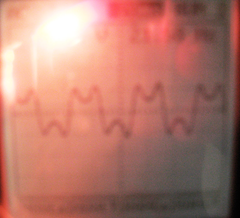

                      I scoped one of my strands of the 8 that are on the coil spinning the rotor by hand, and I got a wave form that you can see below (bad pic sorry). It is very similar to the scope of Ron Coles G Field Under load, seen here: KROMREY CONVERTER
                      Its almost as if the top of a pure sine wave has been cut off and inverted near its peaks. Its strange, Im still trying to puzzle it out. Included is a pic of one of the coils. 2.4 ohms on the power strand/s.

                      Anyone have any ideas on the scope shots?

                        Hi ren, that is the Waveform I've seen with the sec.. I believed it to be a complex waveform, ie 3 or more sine waves superimposed on each other.

                          The waveform is taken with the scope on either lead of 1 strand of the coil, AC. The wheel is spun by hand. This is not the wave form you would see with the circuit running. It is however what the generator coil will show I believe, as my generator coils will be separate from the drive coils.
                          My first window motor which had steel backings behind the magnets showed an excellent, typical AC waveform. The next window motor which had NO steel inside had an unusual AC waveform? The coils were slightly different in geometry and alignment, but I wondered if the absence of steel in the rotor/stator has something to do with it?

                            Complex superimposed waveforms
                            Here it is, I was hoping I'd gotten it on video.
                            YouTube - some scope shots of excited field # 2
                            37 to 39 seconds, but before that you can see 3 individual waves on the scope.
                            I have absolutely no idea what it means though.
                            • #15
                              Very unusual waveforms indead I think that the wave can be altered depending on the magnet spacing on the rotor due to the virtual pole between the magnets, at least i thought someone was talking about that once. Not sure though. I have also seen somewhat similar waves from a coil placed with the outside of the windings facing the rotor, or rotated 90 degrees from its usual face to the rotor that is.
