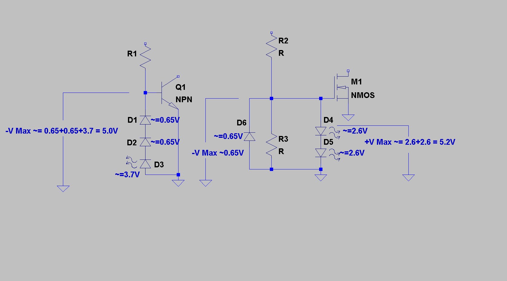

              • Various Bias Techniques
                @All
                The included example shows a combination of bias methods employing diodes and selected LED's as voltage regulators. As can be seen LED's can have different forward voltages and usually this is found by color, so one would assume a RED LED will have a lower forward than a White, etc. A particular LED can be tested with a resistor to protect or limit the current and measure the forward voltage when the LED is connected to a voltage source.
                Ordinary diode also display a fairly level drop in the forward direction and for Si can range around 0.6 -> 0.7 or more and is stable over a defined temperature range, at least for this type of work.
                A word on diodes, power diodes such as 1N4001, 1N4007 etc., are not good at high frequency, although there is what is called an Ultra-Fast version like UF1N4007. They are fair, but not as good as a fast signal diode as the 1N4148. Problem with the 1N4148 is that the good ones from a selected manufactures are only good for 500mA forward in pulsed mode and a PIV of 100V repetitive and Vr is normally 75 volts. They are very low in capacity and are great for this work, if care and correct design is used.
                Anyway hope this helps and this was how the biases are set on my SEC Exciters.
