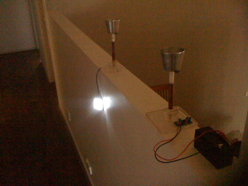

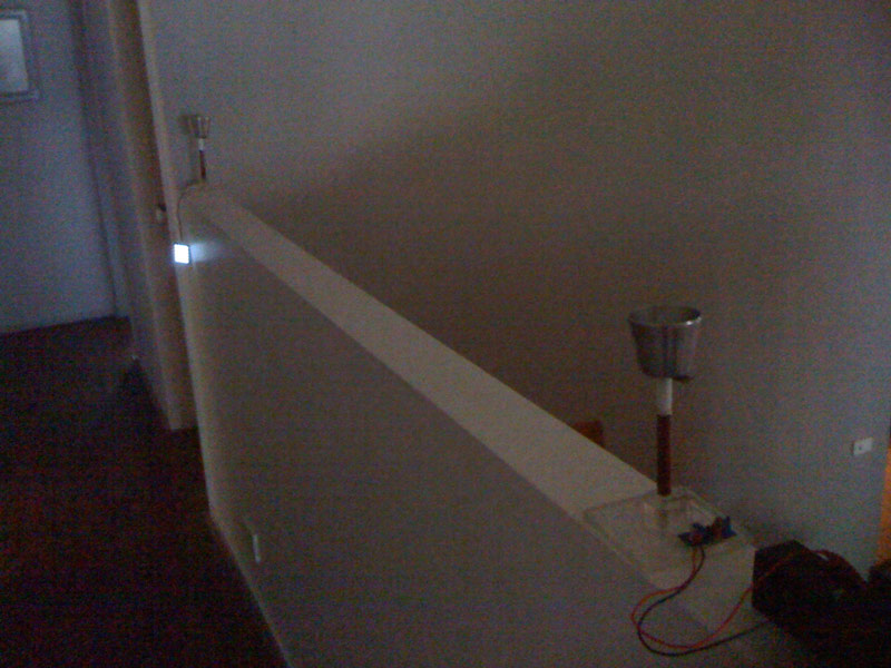

Perhaps the good Dr Stiffler still checks these thread, Im not sure, but here are some things I have been playing around with, Id be interested on his opinion.
I wasnt able to get a full wireless system going this well until I removed the top half of the "tophats" Im wondering if this decrease in capacitance on the top is what helps, or is it that its an open shape now?
Also, I needed to add a short aerial off the 22uH, where you would normally attach the LEDs or loads. The best results seem to be when the aerial (single piece of wire) is pointed directly upwards and in close proximity to the topload. Sometimes I need to touch the top of the aerial to kick start the light, and it will occasionally give you a little zap
Interestingly enough, this system is really picky about which battery powers it. It would seem to me that the bigger the battery is the less distance it can transmit. By far the best results for me came with the 12v 1.3aH battery, so that is something to consider guys when you are testing circuits out. The power source is as much a part of the oscillator/system as any other part...
My best distance is about 6 feet, as seen in the below photos, driving 20 superbright 10mm LEDs in series off the diode plug, although I think it might be assisted somewhat by surrounding but unconnected metallic structures within the wall. It comfortably does 3 feet without any metal nearby, and will run off that 1.3aH battery all night (with it reading 12.00v in the morning). I approximate 50-60ma draw based upon these figures.
All these effects are done with the SEC 15-3 circuit, the above mentioned modifications to Dr Stifflers original towers and CAREFUL adjustments of the tuning inductor. The long distance transmission (6 feet) is particularly tricky to tune to.
Also, there appears to be ideal distances at which the lights are brighter than others. The first distance is when the tower is about 1 foot away from the transmitter. After that there are different nodes(?) or areas where the light output will change, based upon the tuning. So the space between the towers is another variable as well.
Love to see anyone replicate it if they can. Sorry about the poor quality pics, I will have to upload a video soon.
