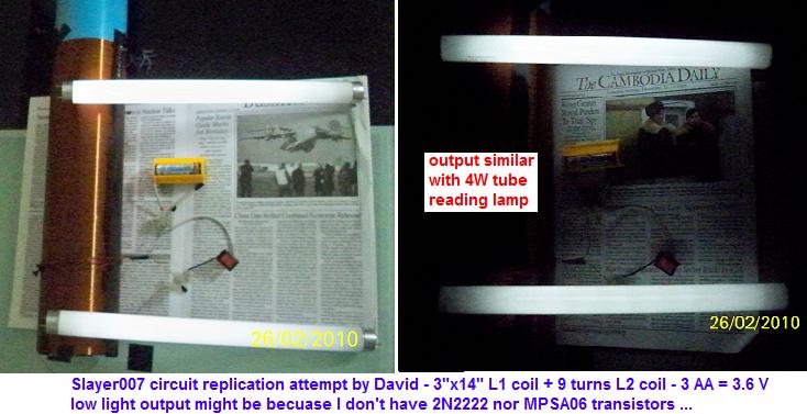

        • Slayer's big coil
          1 # I made a 3" x 14" coil, with a 9 turns L2
          I don't have the big field as Slayer's one, and can just light dimely 2 x 10 W tubes.
          I wonder where the problem comes from ?
          - is it because I am not using a 2222 nor a MPSA06 ?
          - is it because I don't use a breed board and don't have the capacitance effect ?
          I just bought some 2222 today and will try again, with them, when I'll be back home.
          I thought I would be the first to show an "Ever Lamp" (a lamp self-running, without battery nor capacitor), lighting a 20W tube and collecting it's light with my 5 W solar panel to supply the small 250mW necessary to run the circuit (5V x 50mA) but it seems that destiny was written differently... I can't get it to work properly for now ...

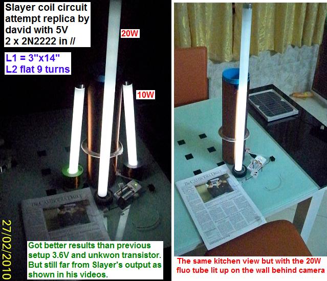

                • Slayer's coil attempt
                  Hi Slayer,
                  I got improvement after using 2 x 2n2222 in // and making a nice flat L2 and using a USD charger 5V from 2 AA.
                  But still I can't get a tube to full brightness, even a 10W.
                  May be it is because I don't have MPSA06, or may be I must change the wire size ...
                  - Did you try with only 2222 and no MPSA06 ?
                  - Did you try without the breeding board ?
                  And to get a good view of the light output, could you make a comparative picture with a 20W lit from the wall outlet ? because I still confused by my results.
                  Thanks and good luck,
                  David
                  • Originally posted by stephenafreter View Post
                    Hi Slayer,
                    David
                    Stephenafreter what size wire are you using?
                    The L1 coil I made I used 23ga. magnet wire and for the L2 coil I used 21ga. plastic coated wire.
                    Voltage also makes a differance in tunning.Try using a higher voltage and also try adjusting your L2 up or down to find the sweat spot.
                    • Tunning coil
                      @Slayer
                      HI, thank you for your reply. I am using #24 for L1 and #23 for L2, but both magnet wire.
                      But I don't have the 2 collecting circuit, BEMF and reverse diodes on supply.
                      Does it work with the same light output WITHOUT the 2 collecting circuit, or are they a must, to get it to work ?
                      Yes I tunned it to maximum brightness by moving the L2 up and down
                      I am not looking for very low input now, but I want to get full brightness on a 10W tube, to make it a replacement of existing devices that run on 12V batteries ...
                      Thanks,
                      David
                      Edit: I just realized that I was not using the right wire size, I will change it to #23 and #21.
                      I just checked size here : American wire gauge - Wikipedia, the free encyclopedia
