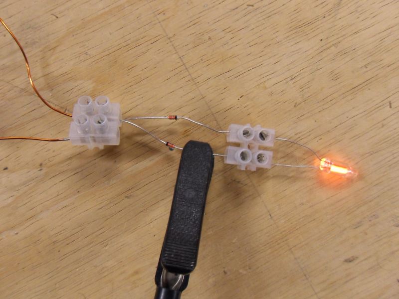

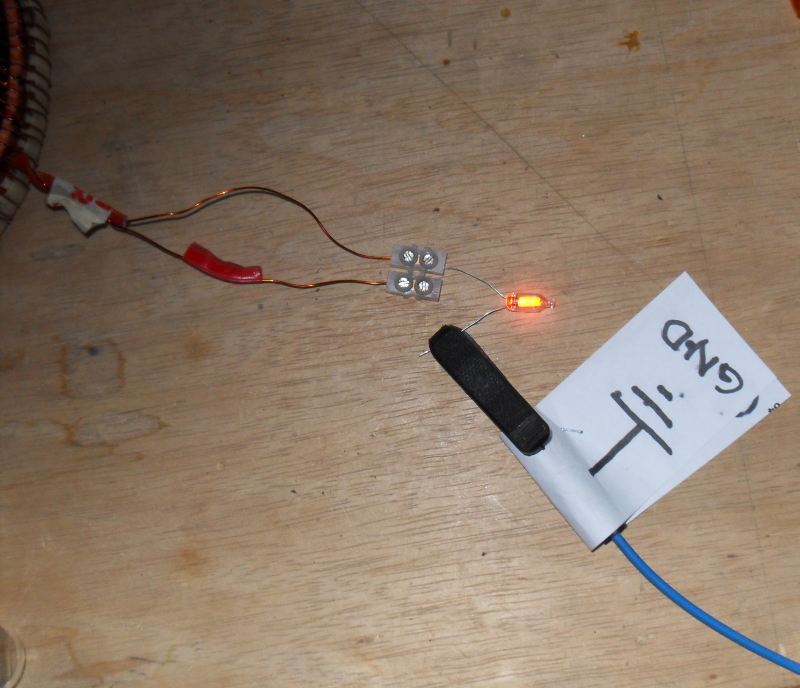

              • only properly lights when grounded
                Hi xee2,
                I thought about your comment and needed quite some time to get it. Then I found you are right. Both electrodes of the neon light up, when i directly connect one leg of the neon to ground as in the attached picture. I was just too negligent to try that before.
                However, the neon will only light when grounded, not when connected to the other end of the circuit. I find this strange and would like to better use the evident potential difference present between the circuit and ground.
                Before I realized that you where right, I had already fabricated a video showing the effects I had described:
                YouTube - 3 experiments with an Avramenko plug
                Thanks kazm for the reminder about your great video. Please let me know when you find a way to light a filament bulb (even a tiny one) with the current that flows in the AV-plug's branches.

                    • @ marxist
                      Originally posted by marxist View Post
                      Hi xee2,
                      Connecting directly to circuit may load the circuit too much. Try putting a small capacitor in series with the neon, then maybe it will work directly connected (no guarantees).

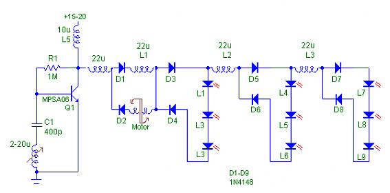

                      • Originally posted by CosmicFarmer View Post
                        Yep. I tried a motor but did not hook it up like he showed. Plus mine was bigger one at .1 amp .......
                        I had the motor on a single set of AV diodes and had the 48 LED transmitting / receiving towers going. When I touched the motor's AV plug hot end to the circuit, the L2 of my 18 series board began to sing, and the lights got so bright I thought I would wreck my led board. The motor did not spin, but it obviously had an effect. I imagined that the extra inductance added something to help with the LEDs.
                        So to make sure, in his video he had one side of the first AV plug go to the motor, and the other end to a "choke" then to another AV plug, then diodes, and repeat, and loop back to the motor. He didnt say it looped back, that's what I imagine happened though, because the motor had 2 leads . Those extra AV plugs and chokes might be necessary to balance with the inductance of the motor to make it operate, while my setup was not enough, however interesting it acted.
                        Imagination can often be a very inaccurate thing and a little less and a better understanding might be better.
                        BTW almost two years back we were driving Muffin fans up to 400mA from 15-3's, I never understand how advancement stagnates and then recycles over and over with no further advancement.
                        The circuit for those that may wish to see the one used in the referenced video is;

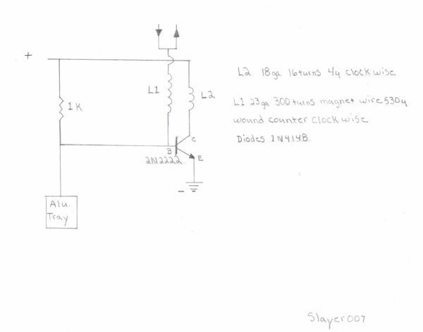

                            • schematic for 'even simpler SEC'
                              Hi slayer007,
                              could you please post a schematic for the 'even simpler SEC' from your video
                              YouTube - Simplified Exiter Version
                              I tried to discern the connections from the video but am just not up to it.
                              and
                              - it should work from a 9V battery, no? (Don't have such a charger)
                              - are the two coils wound in same sense of direction?
                              - is the Alu-tray connected to anything?
                              • Originally posted by marxist View Post
                                Hi slayer007,
                                and
                                The transistor is a 2N2222.
                                L1 is 23ga. magnet wire around 300 turns wound counter clock wise 530u.
                                L2 is 18ga. coated wire 16 turns wound clock wise 4u.
                                Diodes are 1N418 diodes.
                                The Alu tray is connected to the base but it's not really needed for over 3 volts.
                                You can also collect the BEMF off the collector using a 1N418 diode with out killing the light.
