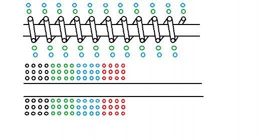

        Maybe I can help with the arc over problem. In the attached picture the top half is supposed to represent a coil wound in the normal way. One layer covers the toroid and then the next layer on top of the first and so on. In the bottom half of the picture, part of the coil is wound with several layers then the next part is wound beside the first in several layers and so on around the toroid. The voltage from one layer to another on the top diagram could be very high if several layers are involved. The bottom picture shows coils of similar voltage next to each other and the highest and lowest voltages are separated around the circumference of the winding on the core. I hope I have made myself clear.

        • Hi Garry,
          Yes this winding technics you propose is surely another solution against arcing.
          Basically this is also what xee2 wrote in his post #2158 on previous page
          ( http://www.energeticforum.com/renewa...tml#post182940 ) and in practice this is used in LCD monitor / LCD television sets to produce about 600-700V 30-40kHz AC for feeding the neon 'bulbs' which provide background lighting for the LCD display. See here such winding technic:
          and some other HV transformers:
          High Voltage Transformers
          rgds, Gyula
