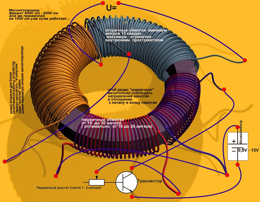

don't know if this is the topic to post this but it's a JT variant so i'll give it a go.
