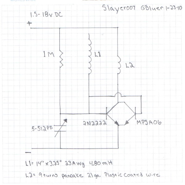

    Thanks Jonny.
    Yes, With the higher voltage the field is a lot stronger.
    I would have to do some test to see if it also extends the field.
    It would be nice to find a transistor that works good and can with stand higher current.
    But so far I think the MPSA06 is the best for this.The 2N2222 also works good with it.

  • slayer007
    Here is just a short video showing the Exiter running off a 12v battery.
    It works off as high as 18v but much past 12v it's still easy to fry the transistors.
    In the video I start it at the lowest setting then turn it up to 3/4 power.
    Here is the video.
    YouTube - Exiter Running Off 12v.
  • slayer007
    Originally posted by jonnydavro View Post
    HiHere is an experiment looking into plasma propulsion using my Bedini exciter.
    I only use the mpsa06 transistor now as the plasma output is very high with this transistor.I also put a 16k resistor from the positive rail to the base of the transistor to ensure self starting when swapping relay coils and i also connected one leg of the slayer L1 coil to the positive rail.
    YouTube - Bedini SEC Plasma Propulsion
    @Jules.Thanks for posting that vid.Quite amazing experiments from someone who really knows what there doing Jonny..
    Amazing results Jonny
    It looks like this is one more Great circuit to replicate.
    Thanks for sharing.
    In this circuit diagram I replaced the 1k resistor with a 1 M resistor and added a 5-512 pf capacitor from the emitter to transistor base.
    This way you can control the current more.And it allows you to use higher voltages without blowing the transistors.
