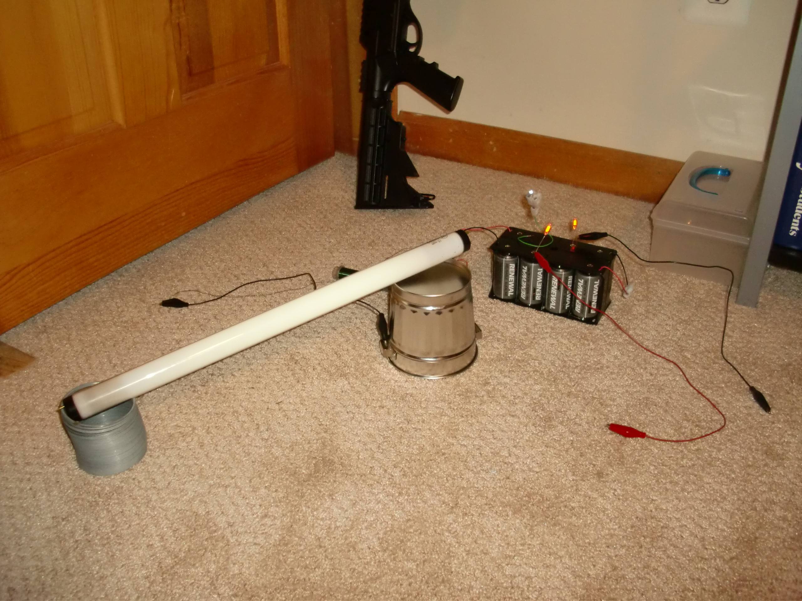

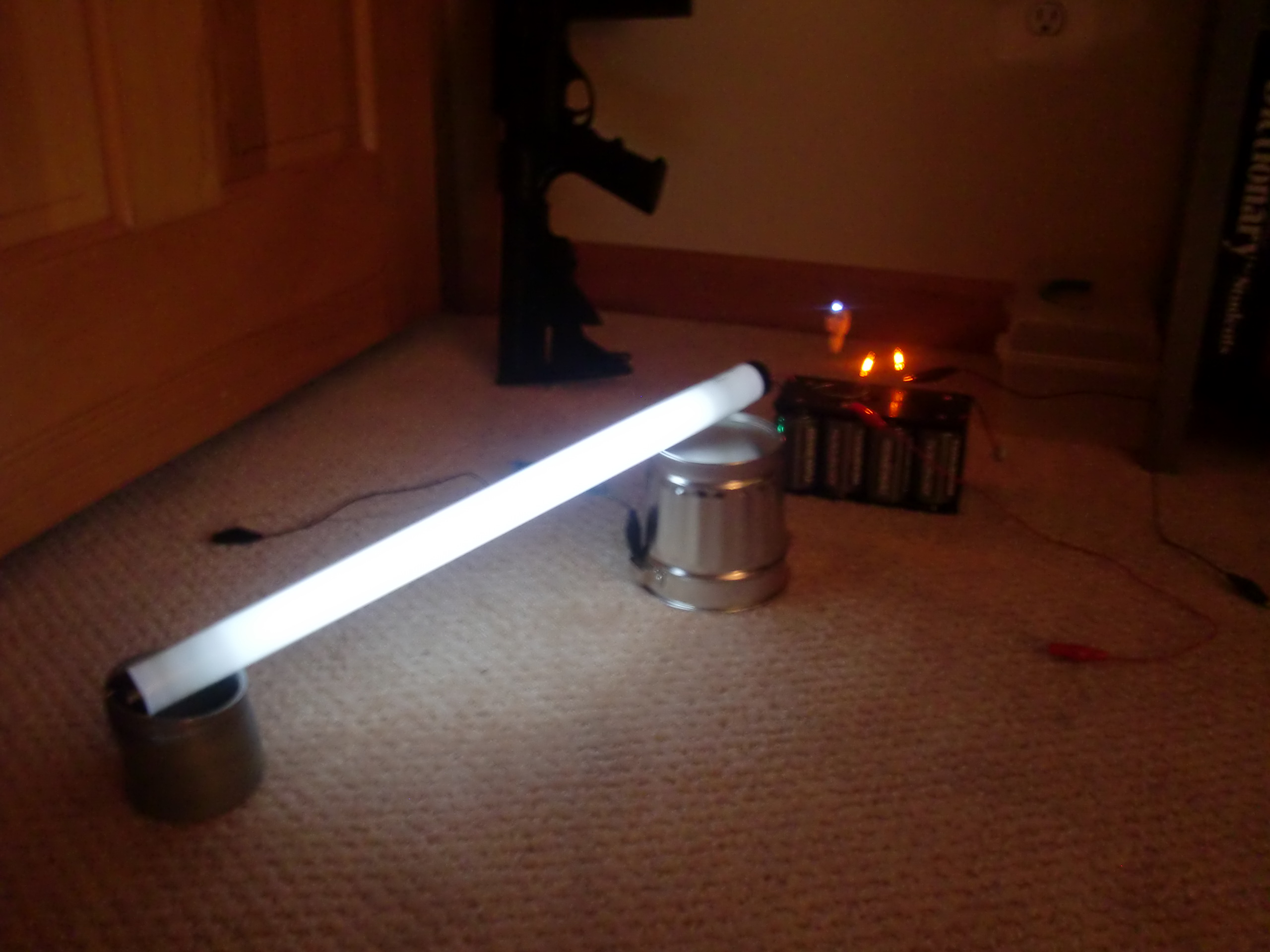

well after a month of procrastination i finally took pics of my slayer exciter and put it back together ya know. i show my mini slayer with the ferrite rod attached to a novelty garbage can and then a fluorescent tube is resting between it and a slinky happily lit up. apologies for the bag pictures my camera dosn't work well with no flash and thats the only way to see the lights

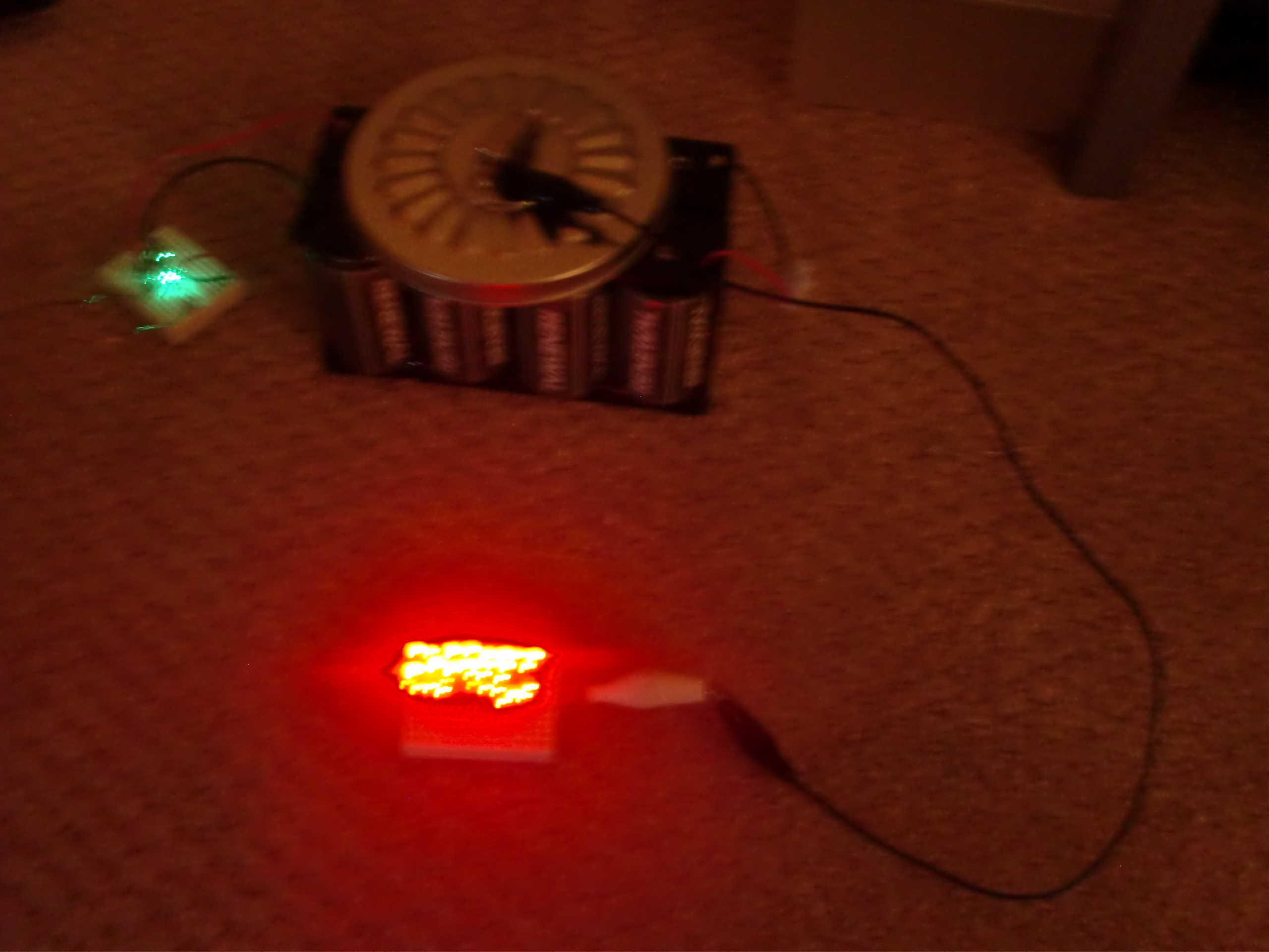

the battery is 8 rechargeable D cells in series to make about 12 volts but with how long ive been using it- im sure the voltage has dropped to significantly less. any way i have two neons lighting up off of some metal contacts on the battery terminals with two alligator leads just going off into space attached to the other ends of the neons. in the next pic i have 32 small red leds in series and an av plug connected to a piece of metal just sitting on the batteries with no electrical contact.
so yeah i know its a little dated but either way. side note i was able to run it without a ferrite rod but when it rand like that it was touchier and wouldn't light up a tube only av plugs but power consumption went down.
