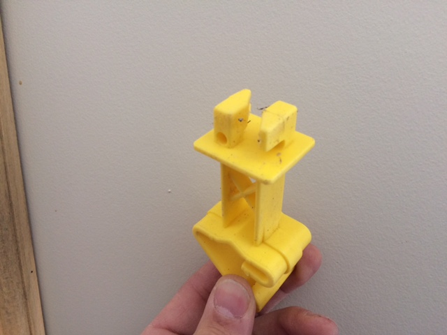

For the ant. Insulator i think to use electric fence insulators see the photoAttached Files

Originally posted by Wistiti View PostFor the ant. Insulator i think to use electric fence insulators see the photo
These insulators will be good for a replication. Not too sure how they will perform if you add a voltage multiplier.
