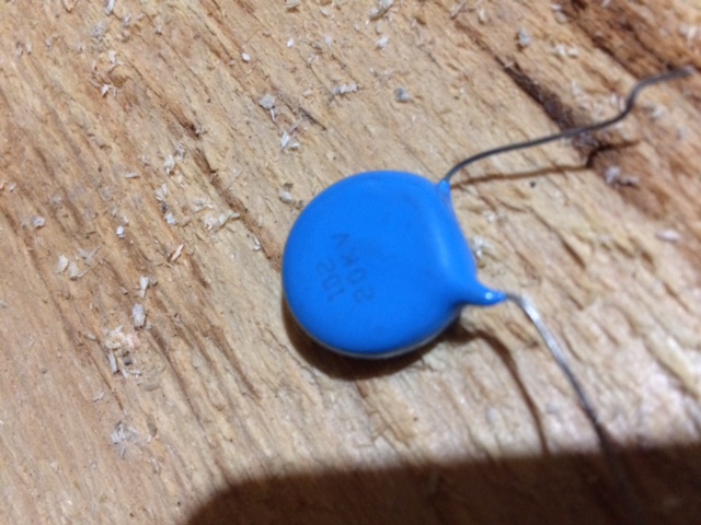

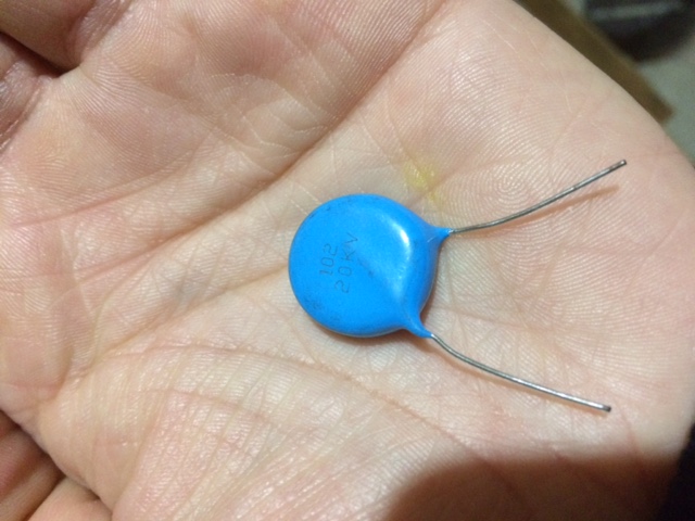

    Thank you Soundiceuk for the reply on the pot. I have another question about the fixed capacitor c1-c2. The one I have under hand are ceramic disc (see the photo) They are quite smaller than the doorknob one I see in the photo of guys steup... Do you think they will do the job?
    • Better scale image.
      • It might work, at least it's worth a try. The amount of ripple current through them is the problem, they will be subject to many charge/discharge cycles per second with every pulse of the PPV. If the gap breakdown voltage was the full 20KV rating of the cap I think you might have a problem with this, but running at a narrow gap width the breakdown voltage is probably more like 1000-1500V and I'm sure they can handle this. I tend to suspect that in the yet-to-be-seen future improvements of the device they will be operated closer to their voltage ratings and you might find them getting warm or failing entirely. But for now I would use them so it's one less part to spend money on.
          I'll find out if they will do for a proof of concept.
          These are what one of the builders is using.
          • Yes, these will work.
            These look huge in comparison!
            • Thank you guys for the info on the cap. It is good news!

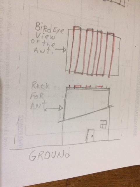

              • A question about the ant. Can the 468ft be put over an existing building (like in the schematic) or it is not recomand??

                  • Originally posted by Wistiti View Post
                    As long as it is well insulated that will be fine.
                    It is only for experimentation purposes and not for use in thunder and lighting storms or you will need a lightning arrestor.
                    Consider Mwtj's grid design also.

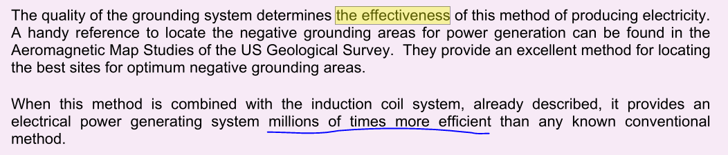

                        • another technical request
                          How much level can the earth ground quality effect an over energy device ? i am doing some experiment where the earth play a critical role , standing waves can be seeing very easily either with a small light bulb or using a scope probes ..
                          all the test are based on the ETBC but with a ferrite rod inside, the capacitors banks can be charged only when there's an earth ground, now the question arise to how much level will affect the system ?
                          thanks in advance !
