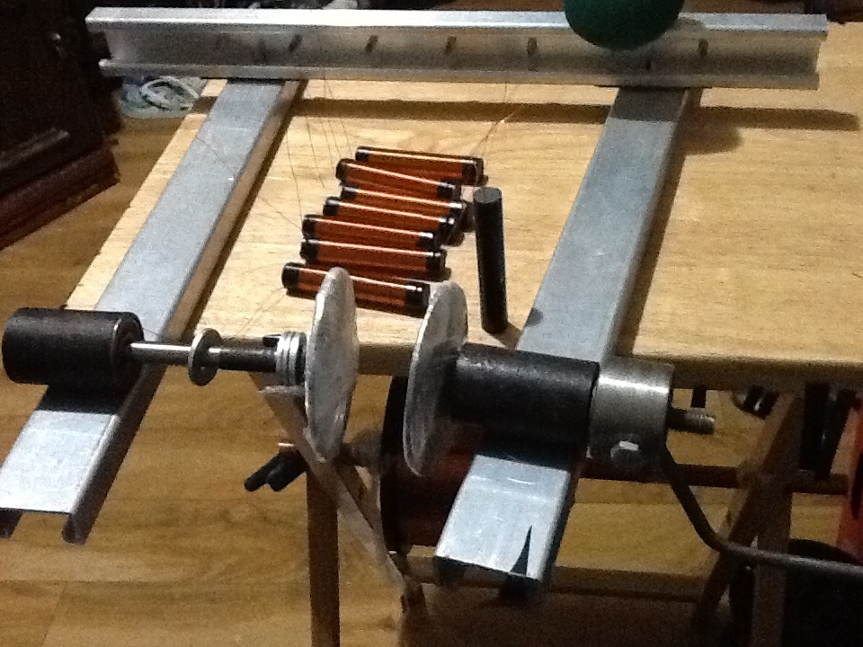

here is what i have so far for the LMD accelerator
...one coil left to wind, then LCR all to identical LAttached FilesLast edited by mr.clean; 05-15-2013, 04:44 AM.In the beginner's mind, there are many possibilities.

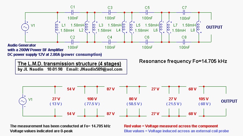

here is the schematic, originated from Eric Dollard (LMD Tesla coil analog) and illustrated here by JLN labsAttached FilesIn the beginner's mind, there are many possibilities.

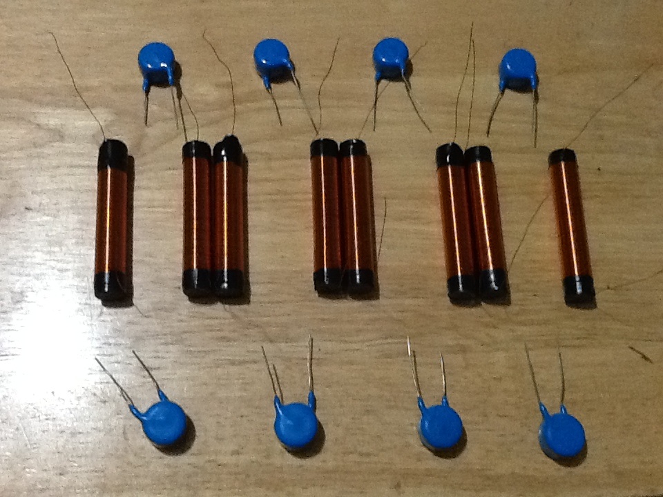

here is what ive got now,
Eight 2.133mH coils, all checked and adjusted identically
Eight 1nF 40kv ceramics
should resonate at 108.96kHz (based on the way Eric and JLN were calculating)
i would use larger capacitance but i just had a bunch of these 1nF so im gonna use those.
this is as far as im gonna go tonite, or else i wont sleep at all
