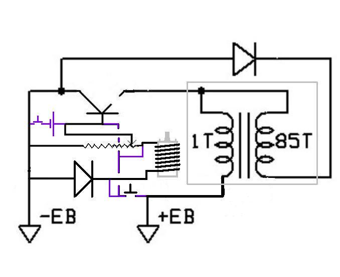

    • hi janost. have you tried a setup where it runs on 3v,eb + b1, and the return all goes to b1,the dry cell ?

          • hi janost. how about a momentary switch and a diode around the E B. to start it.2 dry cells may be required. i pulled that schematic because the E B. discharges through vr 1,100k for me, as well as through t1.still lookin for a more efficient way.

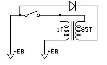

                    • And I figured out a way to do it with my ignitioncoil that is wound in the same direction and one end joined
                      When this one is kicked (the switch, sparkgap etc.) with my EB (or any battery) the secondary jolts back into the battery through the diode with the correct polarity.
                      The kickbackvoltage is that of the secondary subracted by the kickback voltage in the primary.
                      • that's like your basic J.T ,just with switched neg to the centre tap instead of +. and switch off stops the diode from shorting the secdry. nice.
                        • It will need some work figuring out the switching part before it runs.
                          And I wouldnt connect this circuit to a 12v battery like its drawn with an ordinary pushbutton.
                          Push that button and it will bite you

                              • hi janost. i'm thinkin you need a tickler coil. it might take a lot of turns, and a bit of trial and error, so it doesn't overvolt t1's e-b, but starts and runs reliably. usually if a pickup coil (near a coil being driven at audio freq.) can drive cheap lightweight headphones with a bit of volume there is enough signal to switch transistor blocker circuits. i don't know if wrapping the igntn. coil will do it or not, but happy winding.
                                purple bits are starter variations for isolated tickler coil when running. or it might start and run ok or better with + to 3rd coil,try swapping connections,other to vr1.
